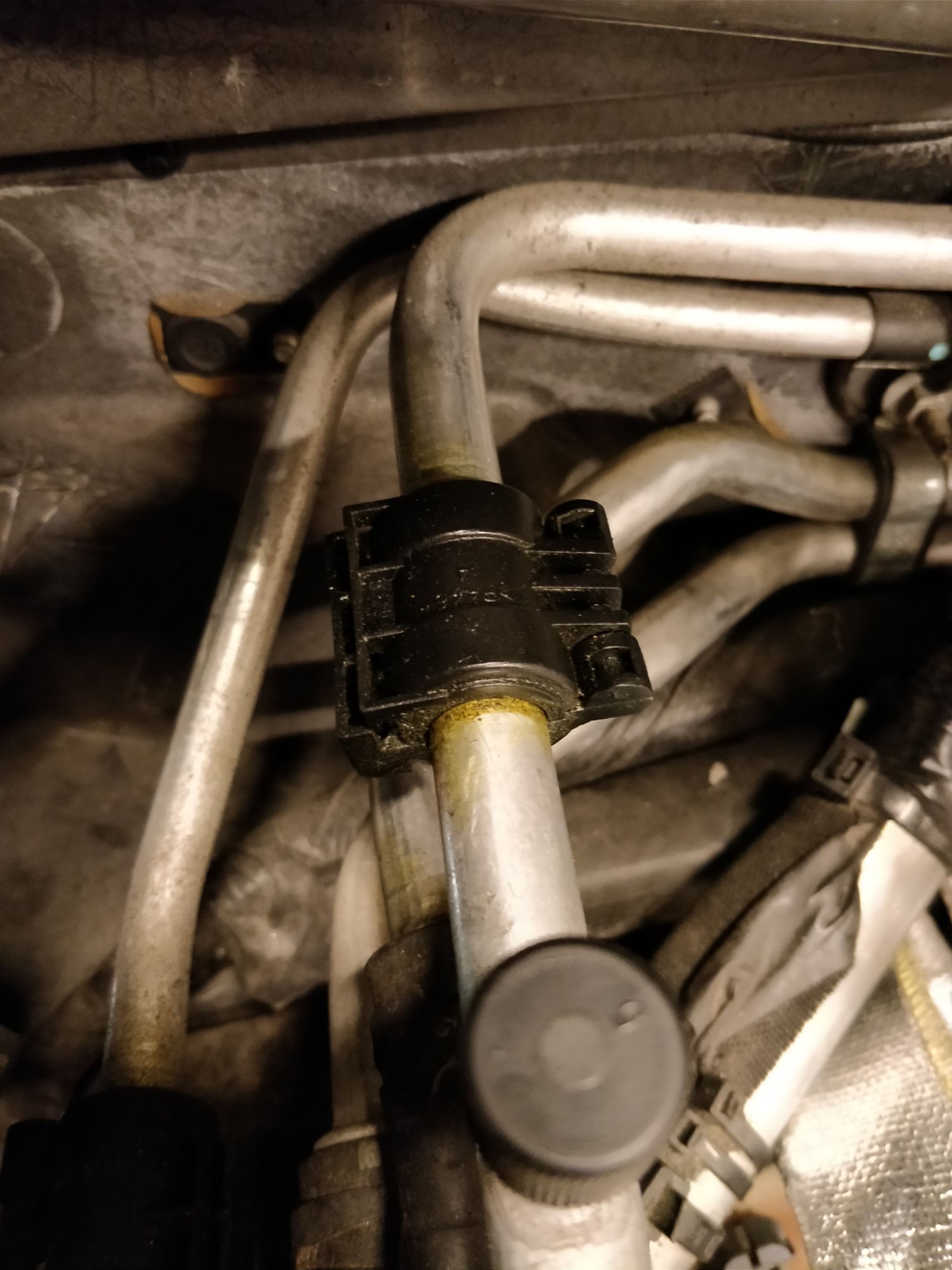

Hi All,
I've found my air conditioning system is leaking badly. There's a fitting on a pipe just rear of the fill connection in the engine compartment of my C6Z that's spewing out yellow fluid.
Anyone know how-to remove this, does it just need new o-rings, or a new part? Part number please?
Thanks!

you will need to evacuate the system then take it apart, probably an oring that got hard and stopped sealing.
