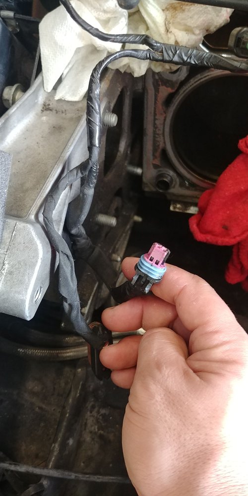

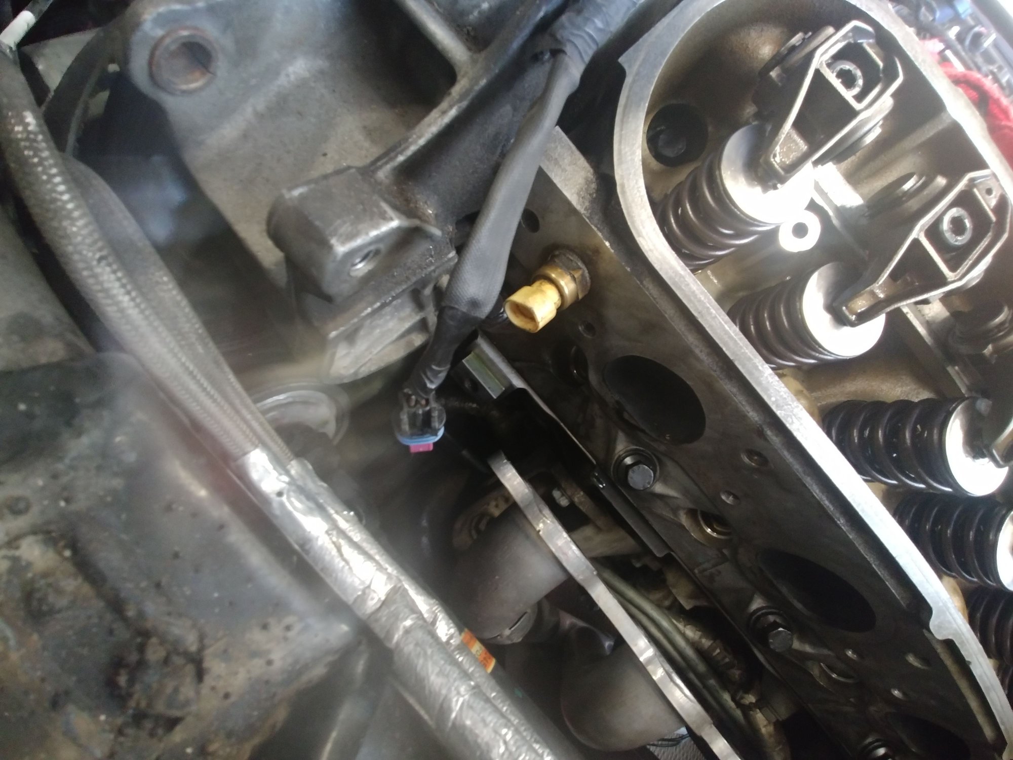

I broke the tab on the connector to this sensor. I think it is the coolant temp sensor. Its on the driver side head. Does anyone have a part number for the connector?

Rockauto has them
https://www.rockauto.com/en/catalog/...connector,2564

If the tab broke only plug it in when done and wrap in electrical tape ir wont fall off the tab just keeps it from sliding off

Pt1798 looks like it. 👍 yeah I was going to tie wrap it or something until I can get one. Thanks guys

Liquid electrical tape, Lowes/Home Depot, 3-4 bucks. I've snapped off so many of the connector tabs (including CAGS & trans temp sensor) & used this each time... easy fix without complications...
