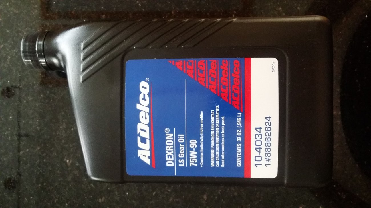

Here is the fluid for the diff,
Here is the fluid for the trans,
To add the fill port are upwards, so you will need a pump and tubing to pump the fluid into the fill ports from the bottle of lube. And again, make sure the car is level in the air so you are topping the trans and diff off correctly.

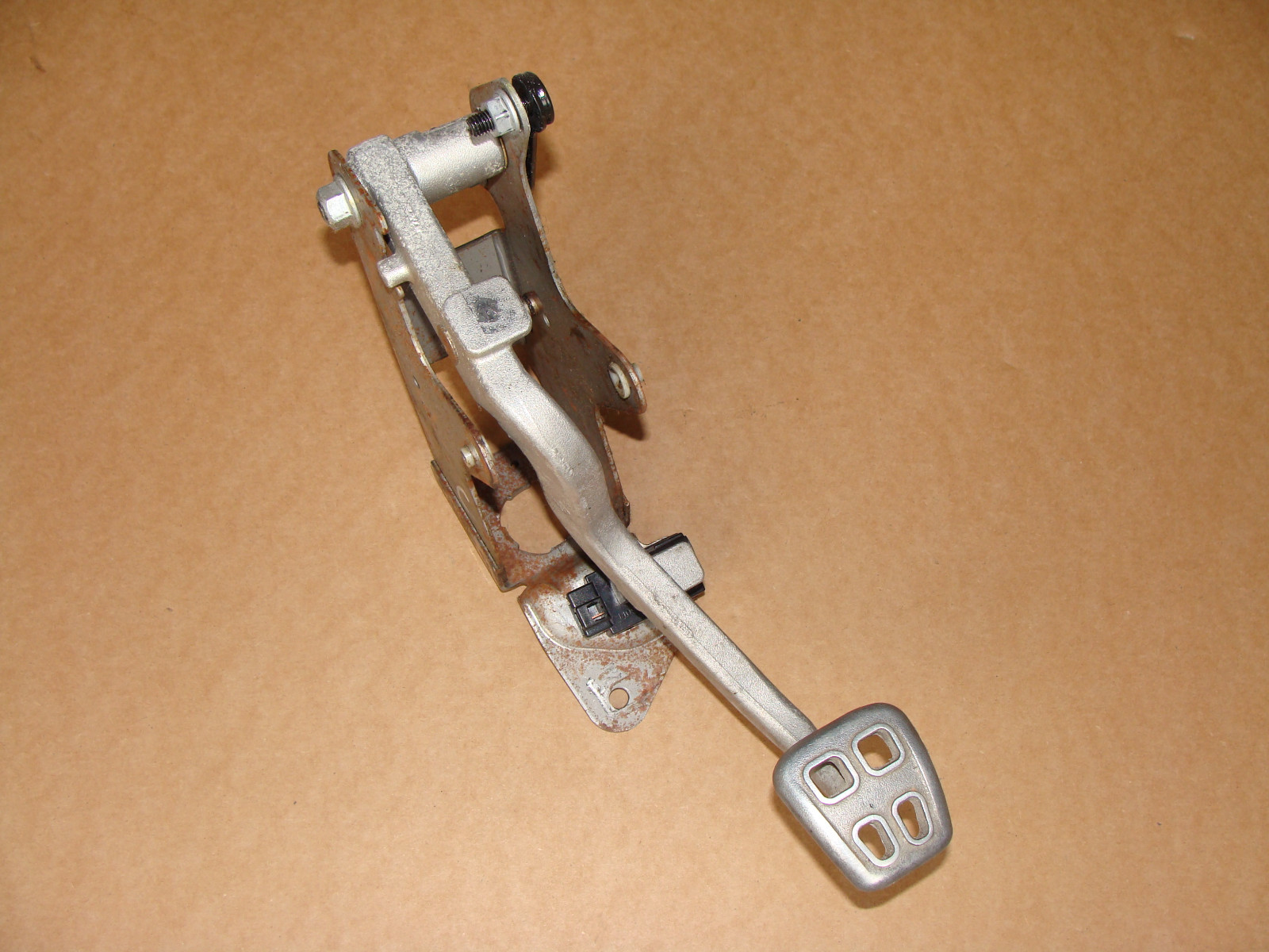

Alright i will check that this weekend. I need to change the oil and do some other little things to it. So ever since doing the Ranger Method my clutch fluid is slowly turning more clear which is good, but I have another question now.
My clutch when i push it in feels sluggish/ a little sticky as i push it in and isn't a smooth push anymore. What could cause that issue?

You need to get under the dash and re-grease all the pedal contact points of the actual pedal system itself, as well as lube the end points of the assists spring and it's loop area to the pedal bracket as well.
Note, nylon cup #11 and maybe missing or worn threw for the spring loop.
While your dug in like a tick under the dash (playing contortionist) pulling the clutch pedal assembly to work on it back at the bench, not a bad time to do the brake pedal as well. Both have inner sleeve parts that run on a through bolts, and greasing all the parts does wonders.
Once you remove the retainer pin that holds the clutch master cylinder shaft to the clutch pedal stud, you can remove the entire clutch pedal assembly to pull it out via is bottom and side bolts, which give you room to pull the through bolt for the brake pedal a well.
