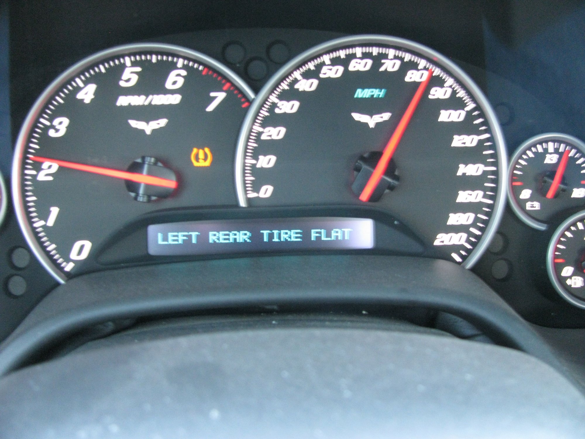

If I get a low pressure warning, does it do anything like limit power or anything like that?
Apparently in a straight line it doesn't, although I've read that it might if you're in a hard turn it'll try correcting you.
I didn't get a chance to snap another pic as I passed 90, so this is it.
