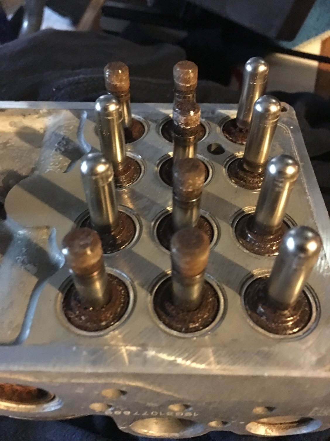

Thank you and my skills are adequate so I got a used one and pulled off the CM but it looks pretty bad (corroded) so probably going to return it and pull mine off and check the solder joints and reinstall.

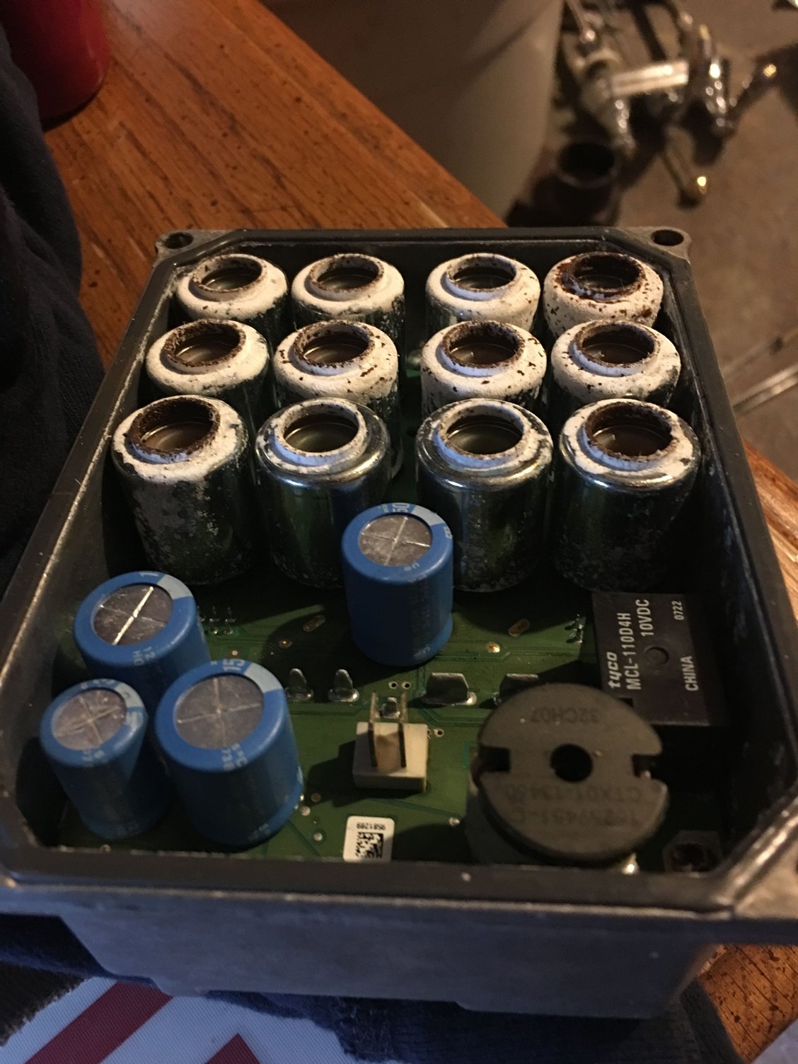

That's the valve side, so stems can be cleaned up, and the electromagnetic solenoid bodies that the valve stems ride in, can be cleaned with spray contact cleaner. Hence when a the coils is energized, it pulls the valve stem inwards into them to close the ABS valve.
Its the board that needs to be pulled out of the case, to check the solder joints on it isntead. Hence when GM solder baths the board to solder it on shot, the longer header pins will draw a lot of heat, and can cause colder solder joints instead. So where you often find the solder joint problems, is the longer header pin instead.
Once you pop the board out of the case, take photos of both sides of the board in detail and post them, and I can help you find the joints that need to be re-solders. Also, with the board out of the case, you can give it a good douching with CRC spray contact cleaner (red can, not the blue can) to clean up the parts bodies and tops of the valve solenoids as well.
