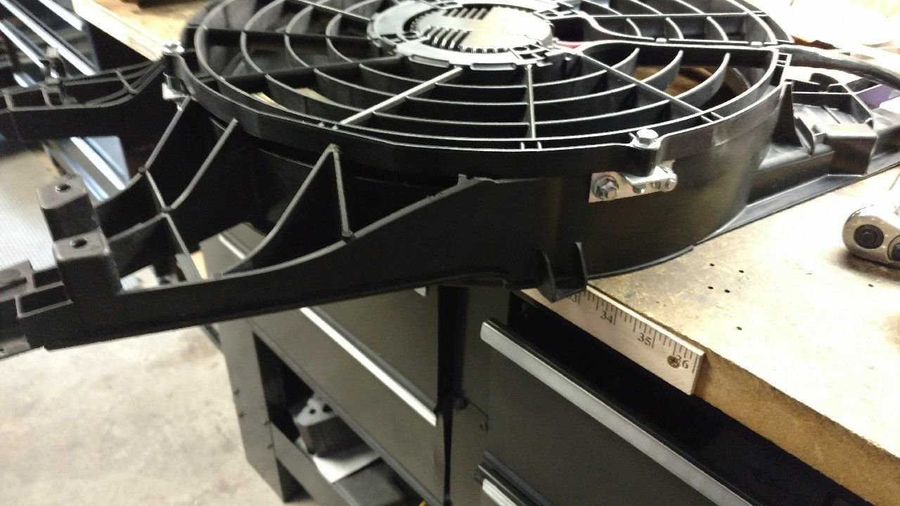

You also need to turn off the computer part on the fan in the car because you do not have the factory controller box hooked up to it. The Dewitts unit is a self contained one so you use everything they give you. On mine I actually put the brushless fan in the stock housing (just cut it out) and I kept my factory controller box and connected the green wire to it so the computer thinks something is there.

The reason your car runs the 180-190 is because the fan is on. All you are doing is just making the car hotter by going to the higher temp switch. Once you are at a stop light and no air is coming in it is going to get hot real fast. AC will also get it hot in a hurry. Having the brushless fan run all the time at lower speeds is not a big deal for it (I think they are rated for 40,000 hours) and they also draw less current. Now if you are always moving and don't do a lot of stop and go then the high temp one is not so bad. You can try the higher switch see if it works for you as it really depends on location/weather and driving habbits. What's nice about my set up is its like factory (milk crate design) and once you get any speed it is a direct blow through - which is better than any fan. These fans operate in 1/3's so 1/3 power at 175, 2/3 power at 185 and full power at 195 (assuming 175-195 controller).
