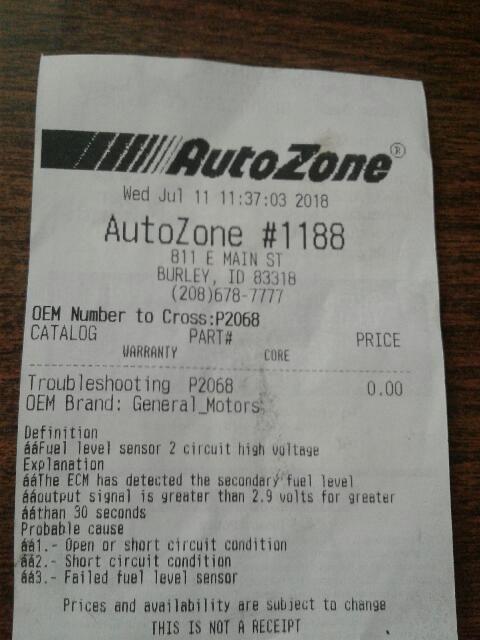

Ok, finally got the codes:
So, am I correct in reading this as the drivers' side "secondary" fuel sensor is the one that needs to be replaced??
no you would be incorrect.the secondary fuel level sensor is in the right fuel tank.right side when sitting in car is always passenger side of any car
Oh, I was thinking since the fuel empties from the passenger side first (at least that is what I think I read) the drivers side would be secondary. Isn't that the more expensive side to replace?
