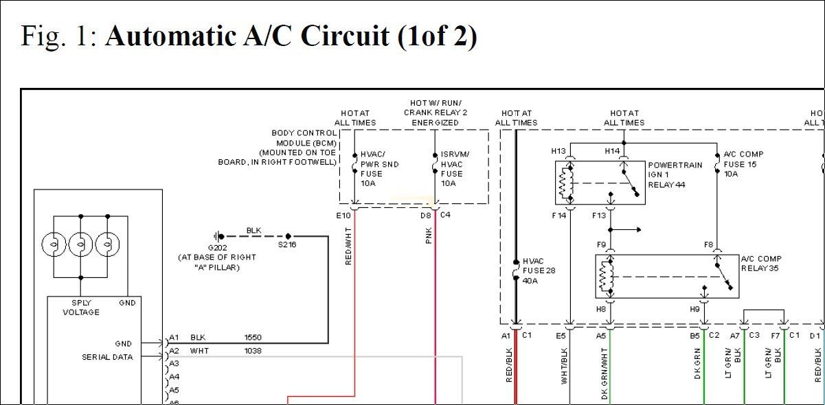

2 fuse in the foot well,
https://www.corvetteforum.com/forums...otor-fuse.html
So far right, second one up on the BCM itself, and the over to the left one row and one up from that one is the second fuse.
Short of this, may be time to pull the HCAC controller to check for a cold solder joint, or may even have to pull the fan motor to see if it's binding up, and popping it thermal fuse/it relay is dying instead.
