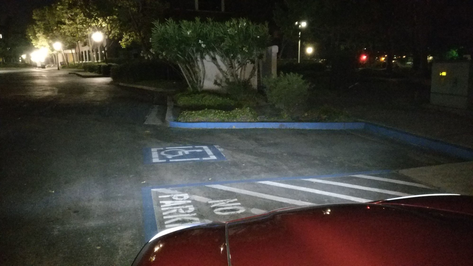

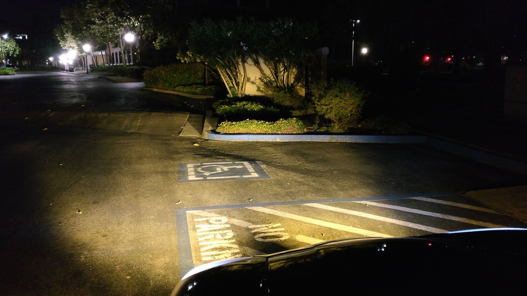

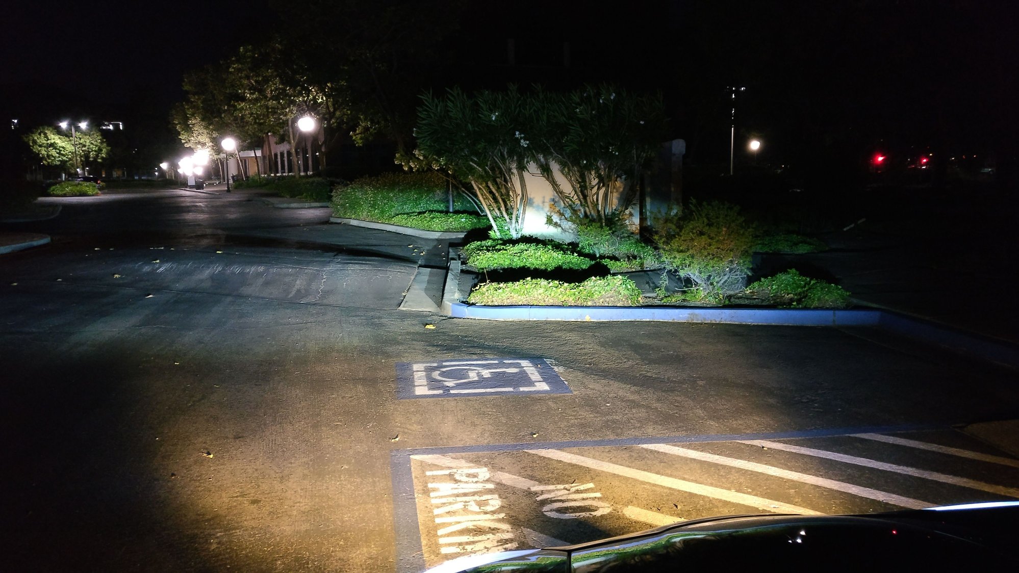

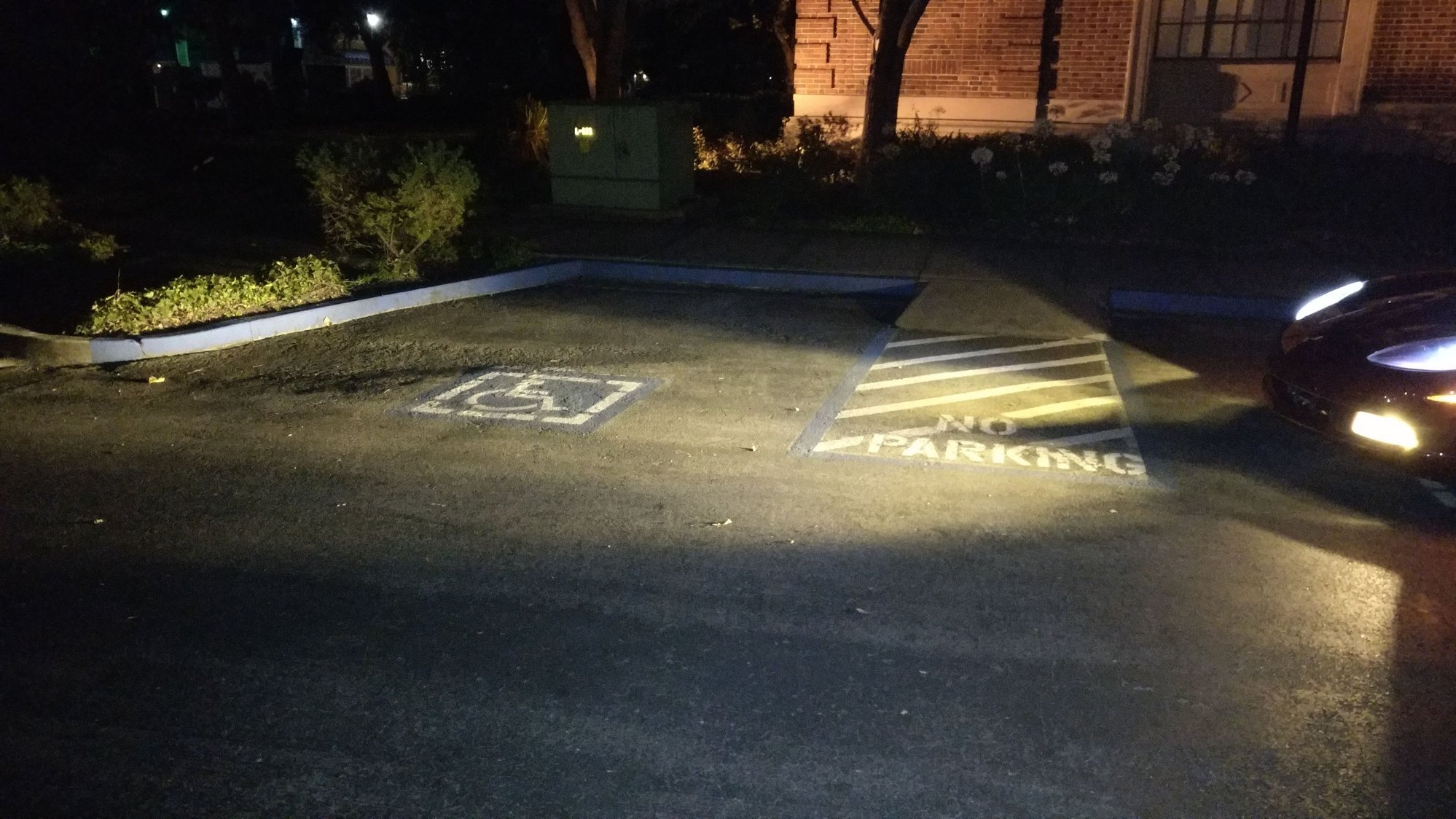

OK, finally got a chance to get some pics of my fogs. I still haven't had time to do the RadioFlyer 55W HID's yet though.
Fogs and LED switchback DRL's
100W 3000K LED fogs and 50 W LED switchback DRL's
everything on
stock HID's and DRL's
50W LED switchback DRL's only
