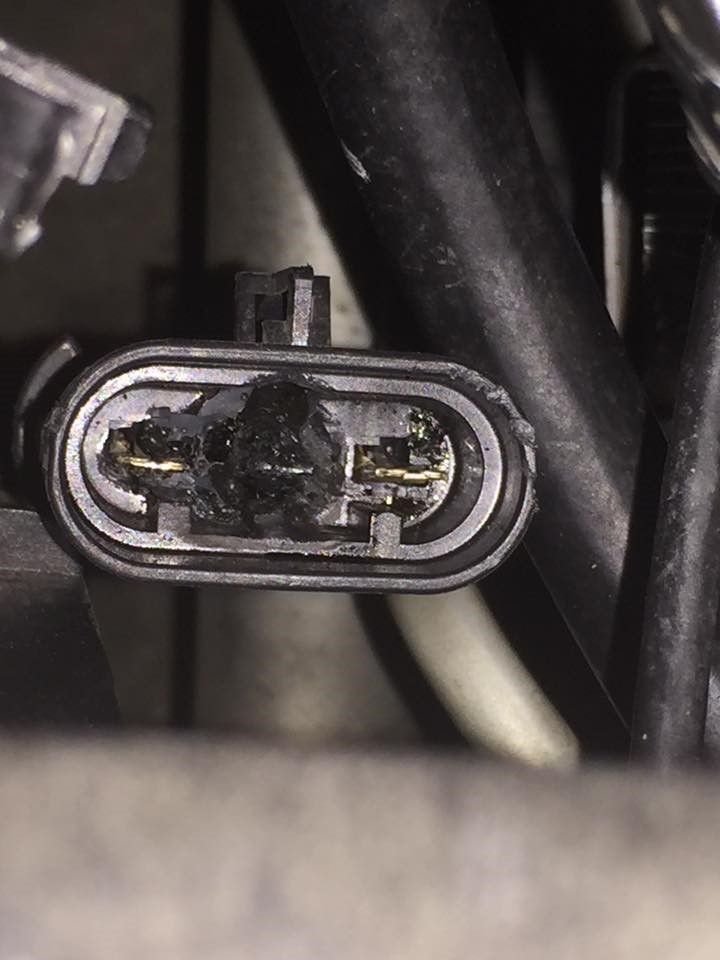

To check the radiator fan, start the car, turn the A/C on, and the radiator fan should be running with the A/C on, even with the motor idling.
If the fan does not come on, then start with disconnect the radiator fan connector back passenger side of the radiator, and make sure that the connector pins are not burnt.
The laser red dot is on the connector,
Attachment 48334002
And you don't want to see this when you check its connections,
If the connector is not the problem, then turn the motor off, reach in and turn the radiator fan blades by hand. If the blades are hard to turn by hand, then may be the raditor fan motor that is burnt out, the PWM, or maybe a fuse back in the engine fuse block.
