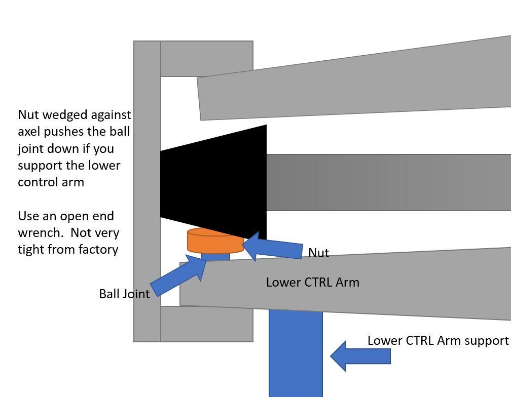

What did you use to loosen the rear lower ball joint nut? Closed end wrench?
i didn’t follow why taking out the two lower pivot bolts let you not pull the drive axles.
And what is that awesome high lift hydraulic jack???

I tried to illustrate with a cheesy picture. Basically grab an open end wrench and start unscrewing the ball joint nut until it wedges up against the axle. If you support the lower control arm and leave the spindle hanging in air the nut will force the ball joint to pop loose from the spindle and you can drop the control arm with out removing anything else. Pull the alignment bolts from the frame, shock bolt, sway bar, and the ball joint those are the only things holding the lower arm to the car.

Got it. Thanks for the super technical drawing as well!
