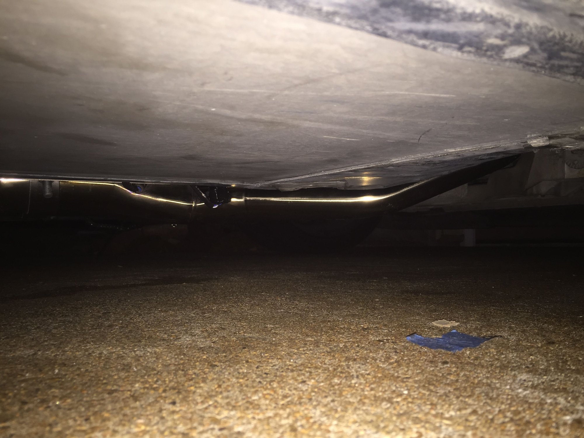

How does the ground clearance look? Can you take a rocker panel level photo to show if they hang down at all for us?

I will get a pic tonight. My car is lowered on stock bolts and I have yet to have any issues with clearance.
