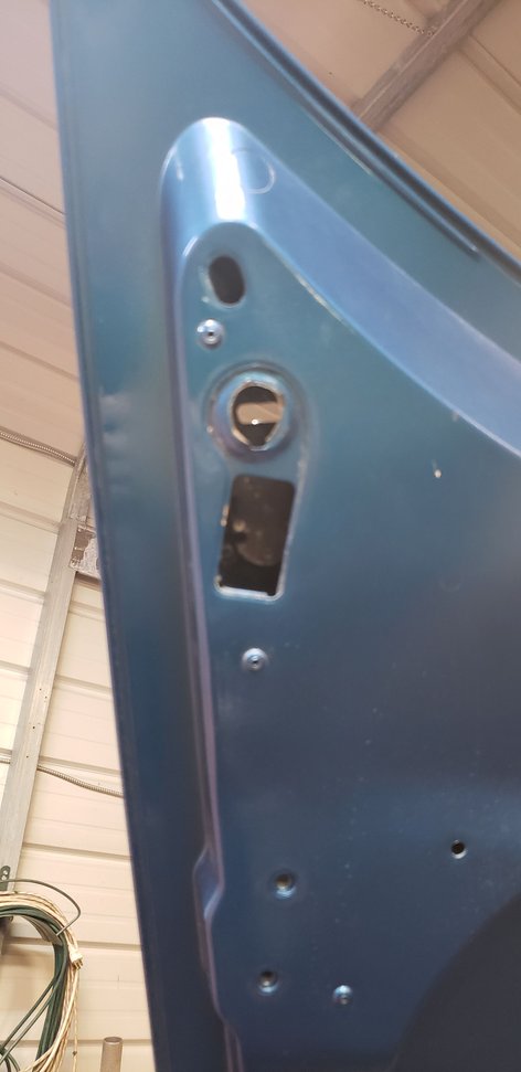

This is what happens when you have an small engine fire and can't unlatch the hood because the release cable melted. The only thing that saved it was that we were able to shoot the extinguishers down through the TracSpec vents and put the fire out.

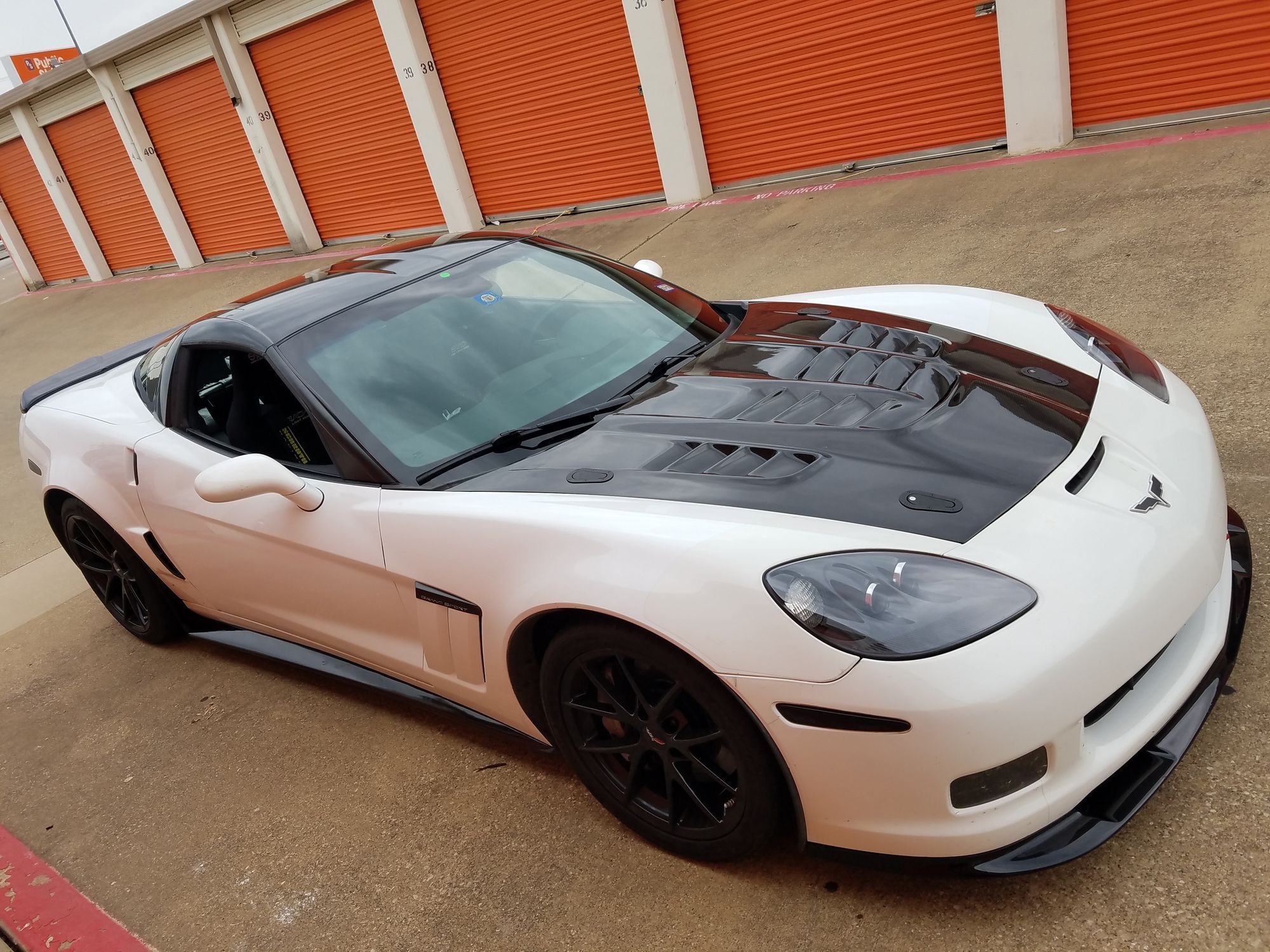

I bought a piece of L beam at Home Depot and had it cut to fit. Drilled the holes to match the stock latch mounting bolt positions for the hatch releases. For the front, I mounted where the stock hood struts mount, and mated to of the L beams together to form a sort of _| |¯ shape to bolt down, and provide a platform to mount the hood pin. I can get a few more angles on the brackets if need be. Install was simple. The hardest part was determining where to cut the hood for the perfect fitment. Mine is 98% correct, as it was all DIY.
