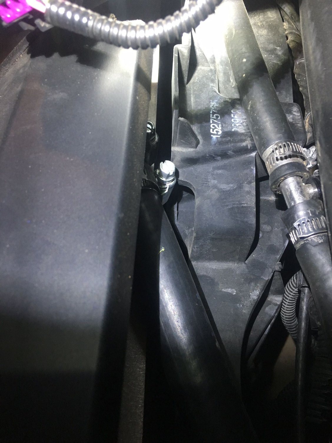

When buying the Dewitt's, factor in a fan system too. I put the short version in a few weeks ago thinking the stock fan should work. It does not fit against the core at all making the fan useless.
To clarify this, the stock fan fits DeWitts standard radiator perfectly. The shorter version radiator doesn't make the fans any shorter.
That is true on the height on the fan. I'm talking about the 1 inch gap around the entire shroud. The fan doesn't seat close to the radiator at all, so it pulls air from all around the core except through the core.
While that gap doesn't look normal to me I'm guessing the ink numbers on the shroud are 1/4" and the gap looks about the same, so 1" might be a little bit exaggerated. I'm going to check it out next time I go in and I'll post my findings
I'll take better pictures in the morning. I'm going to pull off the fan again and see if I can make something to help it.
Why not just get our cut down fan package? Email me tadewitt@dewitts.com

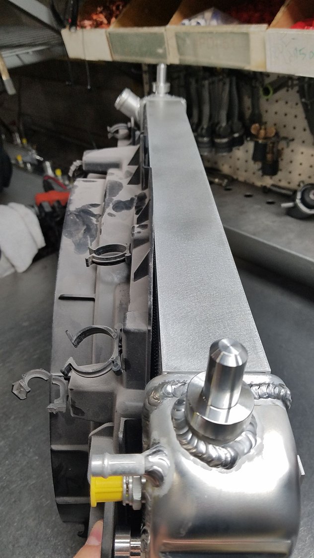

Old Aug 27, 2018 | 04:44 PM
Tom@Dewitt's Avatar
0Tom@Dewitt
Former Vendor
Joined: Jan 2000
Posts: 5,593
Likes: 631
From: Brighton
Default Fan gap
I was in the shop today and checked the fan to radiator fit. The top had zero gap like the original.
