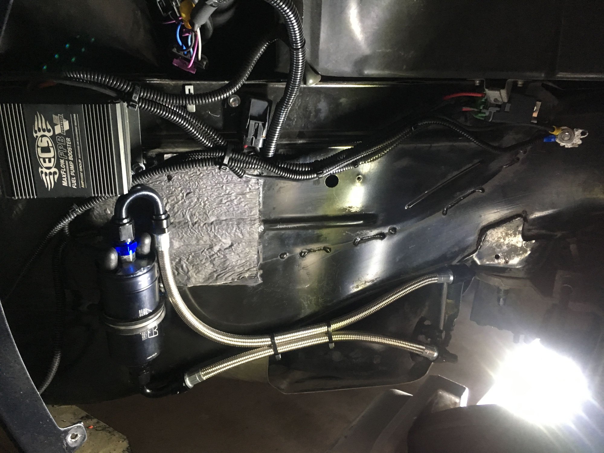

I just installed one on my car over the weekend. everything connected perfect. The bulk head took a few beers but it does go on. I cut a piece of card board and did a few test runs. The only main problem I had was I couldn't get the fuel line disconnect at the tank. If you unbolt the metal pan under the tank it will save your knuckles and you can tuck the fuel line in there easily when you reinstall it.

That setup looks good, I will post my lines this weekend. The length of my lines pulled the fuel pump a lot further to the right. the one you have installed looks like you can still retain your brake duct. I had to go out and purchase new fuel lines as I didn't want to lose my brake duct. Here's what I think happened, when they were putting together the system they put the wrong lines in the box, they may do hundreds but that doesn't mean mistakes don't happen. When I called the guy basically said don't worry about the brake duct, unless you are racing all the time you really don't need it. That was a real big turn off for me because the fix to the problem was simple just add a few more inches to the fuel lines and the problem goes away all together. The pump nor the fitting to the gas tank was ever in question, it was the small dumb s$%t that got over looked. Even my terminals to the fuel pump, I had to put new ones on it because the ones that came with the kit were to big to slide inside the plastic barriers. Again simple fix, it's just at that price, I didn't think I had to worry about small issues like this. A million people can post their experience with the system and I really don't care because I know what showed up at my house and what I did to fix it. In the end, it was just a dumb problem to fix. I know you lowered the pan but I just simply took the whole gas tank out because it was easier to work with an it only took about an hour to take it down. PTA but that what custom builds are all about.
