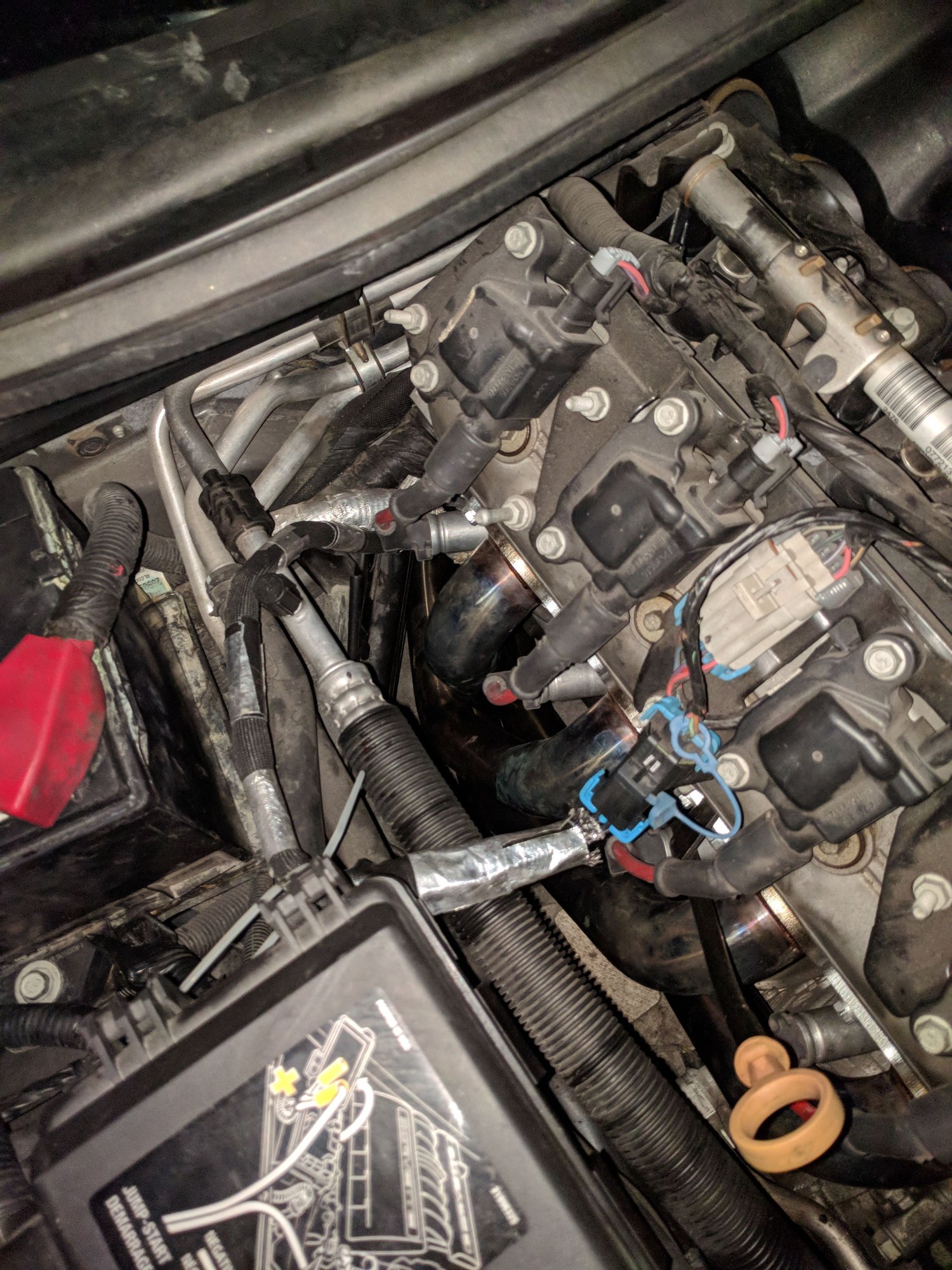

Old Oct 1, 2018 | 12:18 PM
Phoenixtb31's Avatar
Phoenixtb31
Joined: Jul 2018
Posts: 54
From: Myrtle Beach
Default Sensors

Thanks for the additional photos. Did you use the bolts that came with? I'm thinking about buying after market header bolts. Also garage is still to hot so I'm have a performance racing shop install headers and x pipe they are also doing my tune.
October 9th is the soonest they can get me in and I do have 31 inch 02 extensions being delivered this week. Thanks for the heads up.

Just for reference, when I installed Z06 manifolds and associated cats/pipes on my '08, I stripped back the tape on the harness and didn't need extensions for the O2 sensors. A few years later when I changed to LG headers, the OEM wiring was still long enough for the sensors. It's because the base OEM harness has the same length wires as the Z06, but they are taped differently to access different sensor locations.
So I'm guessing, you never disturbed the OEM harness, since you had length issues. A couple minutes stripping tape, pulling out the sensor wires, and re-taping may have resolved your problem. It might have also made extensions unnecessary.
Old Oct 1, 2018 | 02:10 PM
Phoenixtb31
Joined: Jul 2018
Posts: 54
From: Myrtle Beach
I could see that being the case. You're correct, the front 02s I pretty much left their movement limited to the OEM taping.
