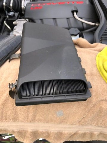

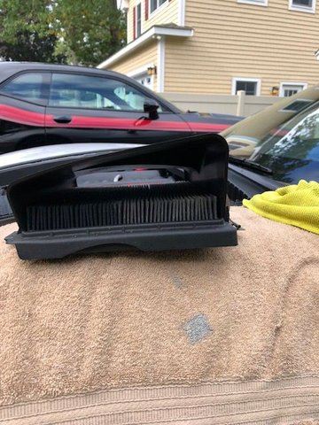

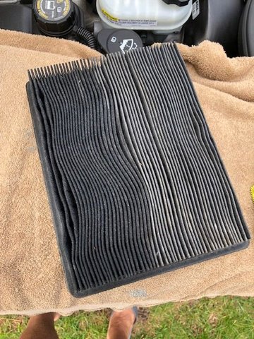

So I took apart the MAF sensor, it looked good, cleaned it but before I reassembled it I looked at the throttle body. It was clean BUT the rubber boot between the air flow and throttle body had water in it. Dried it out and back tracked to the air cleaners. Both of them were wet half way up (photo), found water in that compartment as well as the bridge between both filter. Got caught in some rain last week.
See photos, are these the OEM air cleaner housing? They are wide open on both ends.

Air Filter is OEM...doesn't look like the housing is aftermarket. That might have been your problem right there with the air filters water logged. I'd replace the filter...OEM has 2 filters I believe.. I have a C5

Yep stock air filters and housings.
Replace the air filters with either the Napa golds, or Wix white filters since they are the same two filters.
The white Wix/Napa gold filters flow a touch better than the OEM filter, but better is since they are white, you can see when its time to change them when they get dirty instead.

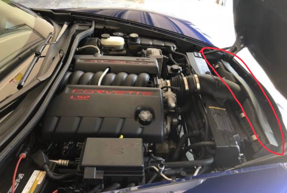

After looking through a number of classified ads for C6’s I think I know why the filters may be getting wet, we’re missing a shroud over the air filters compartment, see photo. Thoughts??

https://www.wholesalegmpartsonline.c...g=air%20filter
Gm 10381295 and check on line since you should be able to get it for around $20 new.
Also, quick photo down at the area below where the filter housing sits, since someone may have cut the air shroud for an after market air filter system like a Varram, and this is allow for a lot of water to come up as well. Hence when you look down below the filter assembly the plastic should be solid with no holes cut in it.
https://www.wholesalegmpartsonline.c...iator%20Shroud
If you find a hole cut it it,
GM 10305278 for about $60

So to put a period on this thread, the cause of the surging was water.....water in each of the air filter compartments, the area in between the air filter compartments and the rubber accordion boot after the mass air flow sensor and throttle body. Once the water was absorbed and the air cleaners dried out the car pulls without hesitation up past 100mph.
Guessing the missing housing using noted above allows the rain water to ingress into the air filters and beyond. The other housing noted above was not tampered with but did find several openings that look like something should be attached to it, thinking the missing housing. The housing and new filters are on order, s/b here by Monday.
