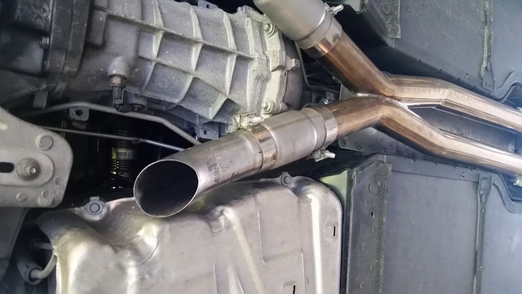

i saw saw that this guy had done it
[img]webkit-fake-url://8384f8f5-6fe6-458f-baa3-45d6a12951fb/imagepng[/img]
And the muffler I got is even smaller. If there's room for x-pipes to fit there then I don't see why a small race muffler wouldn't fit right?

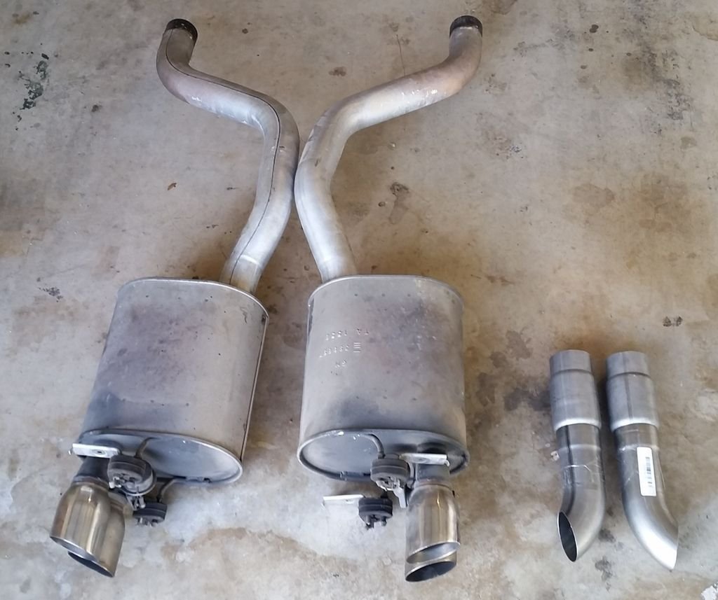

heres what i did 3" bullets with turndowns
it was too loud for me. were on the car 20 minutes. make me a decent offer theyre just sitting in the garage now.
