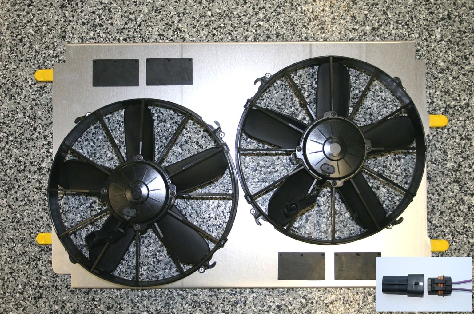

Hi guys already bought dewitts dual fans for my 2010 vette
The problem i don't know how to wire them to the control module each fan has its own connector .. Need help with that

You need to make a connector that combines the 4 fan wires into 2. Then you can splice your controller harness and put a 2 wire connector wire. But you need to make the 4 fan wires into 2 wires.

You just plug them in. DeWitts customizes the fans to have matching GM plugs
I don't have the harness only fans with there connectors and they don't fit with oem module
Hold the phone, those pictures are the SP015 for a C5.
The C6 uses SP463. This one does require cutting and splicing in the new plug.

Tom, I think you are correct and if those are 12 inch fans that is nice but they wont fit the C6 which needs 11 inch fans.
Click Here
Ok got i will do some modification to fit c6 and use with oem control module..... Thx
Yes those for c5 🤔 the one who sells me those was not honest with me, but i can do somthing that will fit hopefully
Bingo! They won't work.
