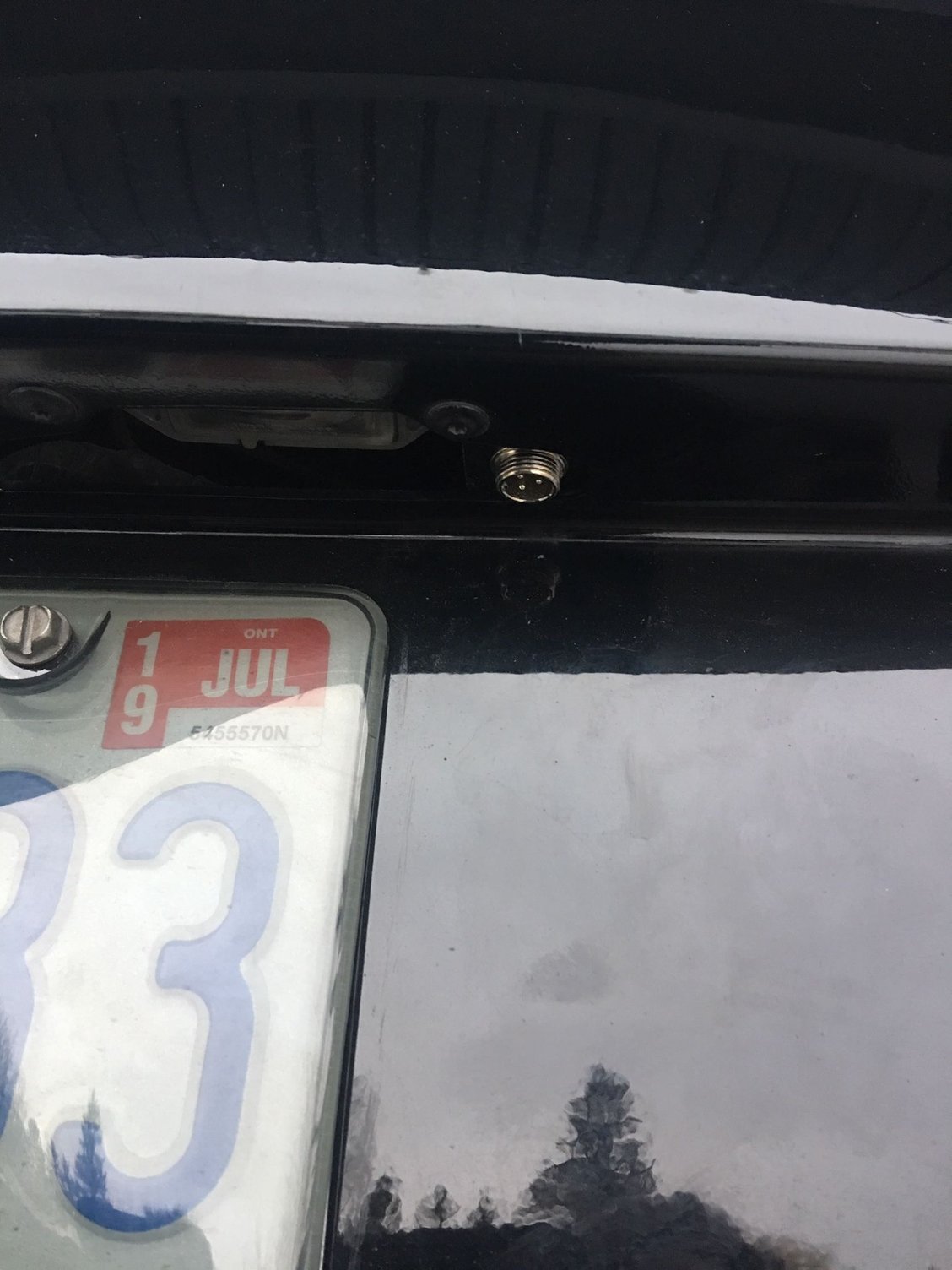

Thanks for the great info, guys. Should receive ammeter soon and I'll check. Thought I would post pics of my hidden Ctek connector
