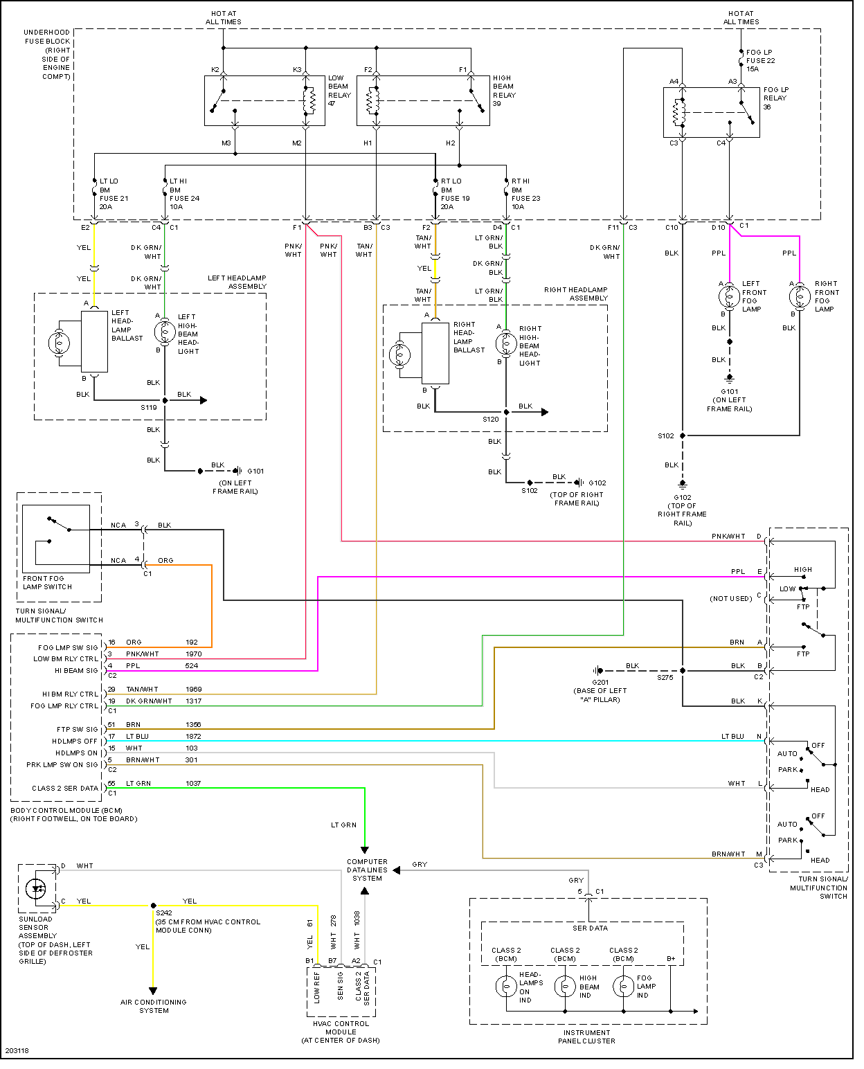

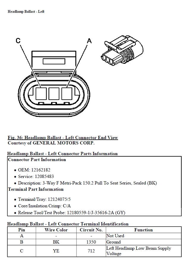

I would see if power is getting to the ballast from relay and then from the ballast to the bulb. It says that you have changed parts, but did you test the circuits to make sure that power is getting to the bulb?
Just my opinion on what I would do.

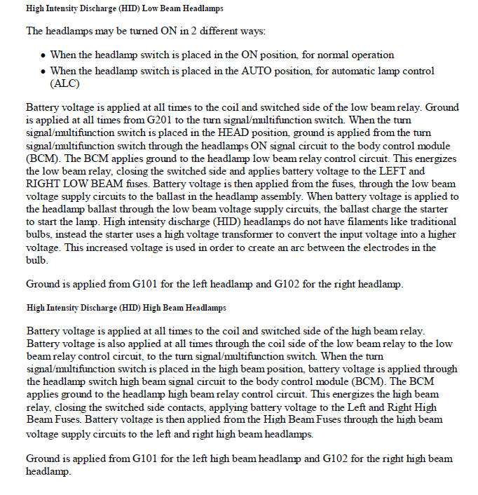

check if the fuse box got power first
watch this video to understand the basics
