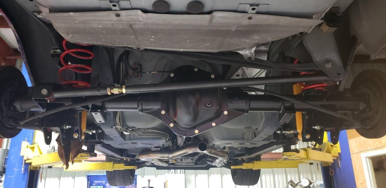

Hi all. Been a long time since I have posted but I have some questions that I'm sure some of you can assist with.
I no longer own a C6. After having two of them I can still say they are one of my most favorite cars to spend time in. That being said at this time I have harkened back my 20s and find myself owning another F-Body, a 1999 Camaro SS 6 speed manual. I know I know, but after seeing it I couldn't say no. I feel like I am back in college with my 2000 Z28 again!
I picked the car up last summer with 54k miles on it. It's a one owner car (before me), had two sets of tires since new, one set of spark plugs, regular oil changes, and the only mod was a K&N filter. So to say it's bone stock is an understatement in the world of "every LS1 F-Body is modified". There is not even a CAI on this thing. But I bought the car because it makes me smile. Could have had a new Vette but the C7 just doesn't make me smile and after two C6's I was ready for something a little different and I can enjoy with my 4 year old daughter, who BTW has a "Corvette Girl" shirt she asks to wear.
Before I started with power mods first and this time I started at the other end of the spectrum. So far I have the following.
1. BMR Stage 3 handling package with Koni adjustable shocks, includes sways and springs
2. Strut tower brace
3. Subframe connectors
4. Adjustable pan-hard bar
5. Adjustable lower control arms
6. Dana S60 rear with 3.73 gears and chrome moly yoke
7. PST aluminum drive shaft
8. TSP 1 & 7/8 headers
9. TSP catless mid pipe
10. Electric cutout
11. Tune
Knowing the power I want to make I will absolutely be replacing the stock T56 with a Magnum T56. Sticking with the 2.66 first gear and the .63 6th gear. So the engine I have decided on is an LS7 441 stroker.
I am looking into resleeved LS7's with a stroker crank. Original goal was 600+ rwhp but I'm not chasing a number just for the sake to do so. With the Dana S60 sucking some extra power and the 3.73s giving a lower readout than say 3.42's I am still looking for high 500s but peak power it's not my main goal. With the 3.73's I am ok with not having a stump puller of torque on the bottom but a super high strung rpm engine isn't the goal either. Somewhere in the middle to make the car fun in any driving condition is my goal.
Anyone build a similar style engine or have some good ideas? I have done some searching but am by no means an expert. My thoughts are 11.5:1 compression, PRC 265 heads, 113 .630-.650 cam, Mamo ported MSD Atomic intake.
Thoughts?
Attached are a few pics.
