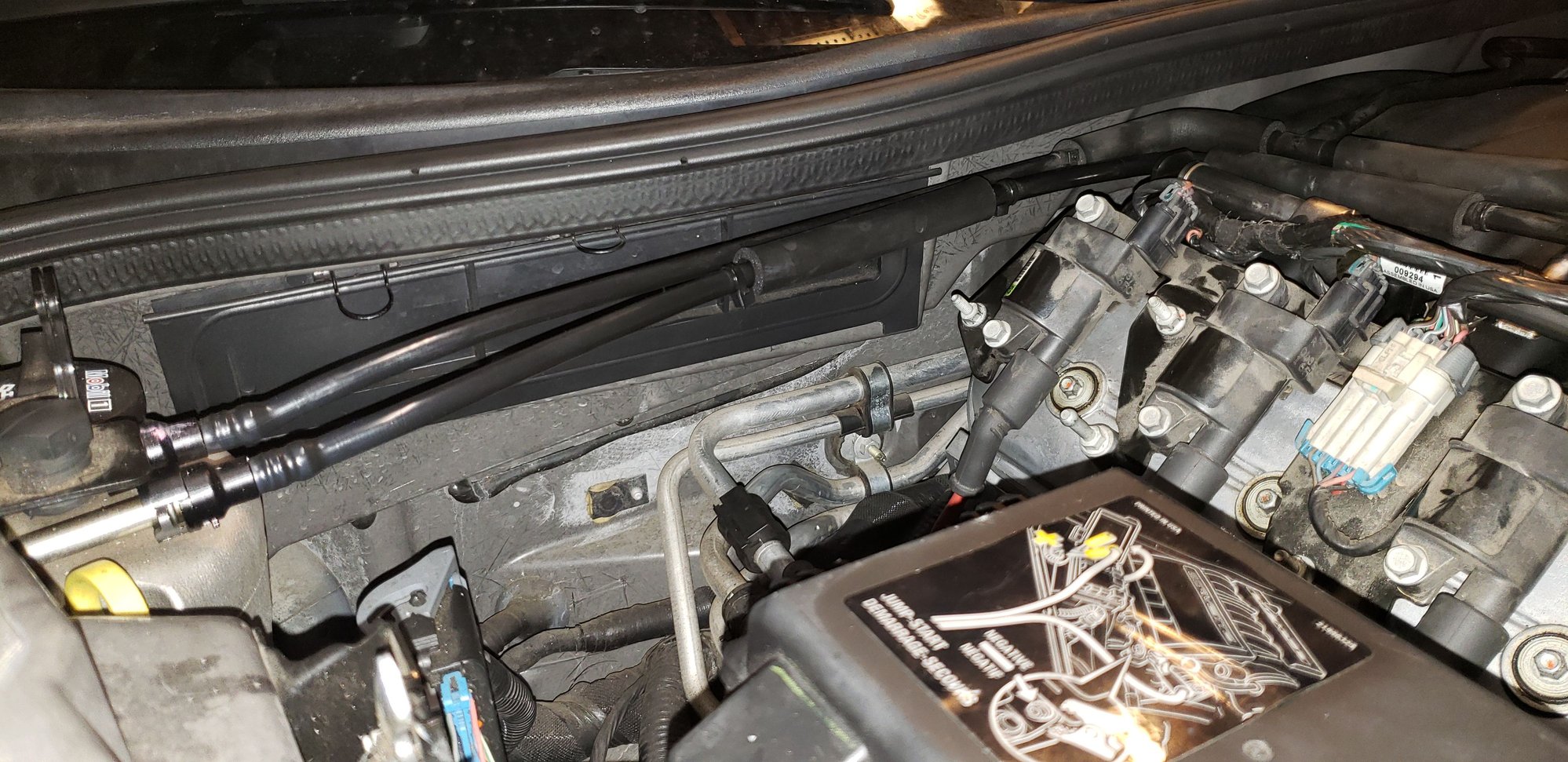

sorry 07 z06 i wanna all the vacuum lines routing i just would need a close up pic of engines to see routing thanks unless u can see something wrong in pic

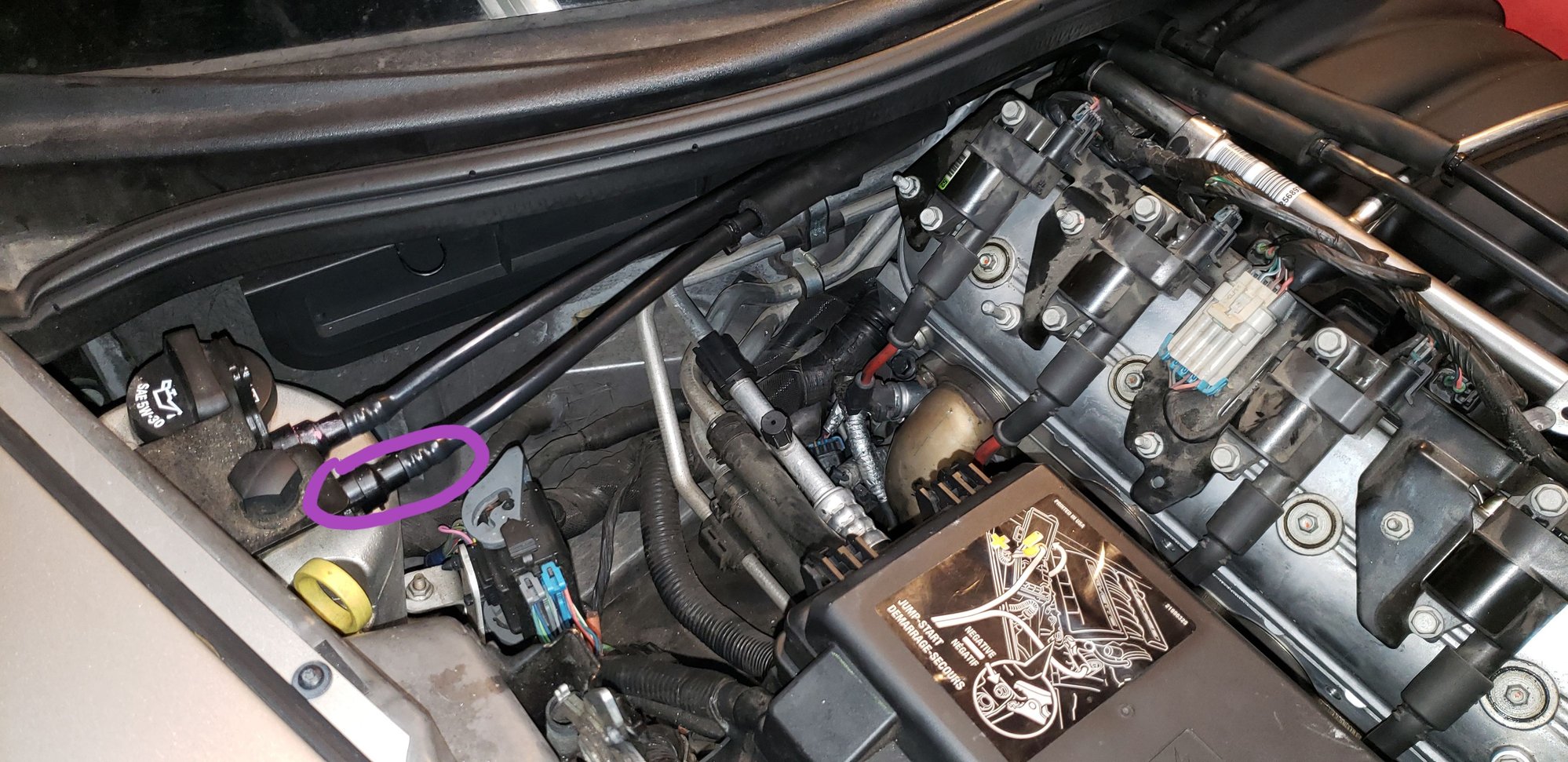

Default Does this help?
Pay attention to the one I've circled. If that isn't the one connected to the accordion coupler on the air intake then it'll pump oil where it's not supposed to go.
This is from my 2006 Z06. Let me know if it helps.

i keep getting a p0106 code i need a close up of both side where all lines are routed thanks here is mine
