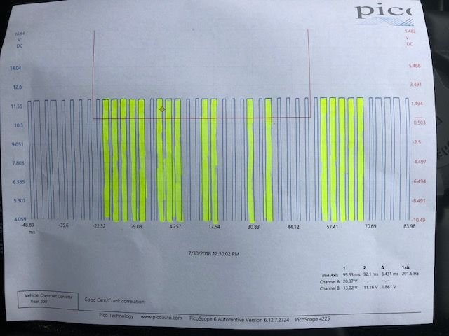

C5’er here but you really need to scope your cam/crank sensors to actually see what’s going on...yes, it can be a cam or crank sensor or even a worn timing chain... if the chain had skipped a tooth or installed one tooth off it would probably be running poorly !!... here is a cam/crank correlation on my 2001 (LS1)...my crank sensor is a 24X and cam a 1X as you can see here...you basically have to compare how the cam sensor waveform lines up to the crank !!...oh, BTW if you changed that cam sensor you should do a crank variation relearn...Tech 2 or a bi- directional scan tool needed for this !!

I have my own scope (Picoscope) but any diagnostic shop should be able to do it for you !!...takes about 30 minutes..,you just have to back probe cam and crank sensor signal wires at the PCM...easy peezy !!

This P0016 code is a cam/crank correlation code. I would doubt a dead sensor could cause this, it is a logic concern, not a circuit or sensor concern. I could see needing to do a crank relearn if the engine was just built, but for it to just randomly set this DTC out of the blue? It doesn't "forget" where the crank is, so shouldn't need to relearn it like it's some sort of maintenance item. Scoping would give a good idea to see what the ECM is seeing, but considering you mentioned it ran fine, timing probably isn't off. My suspicion is the reluctor wheel spun on the crankshaft, considering it is just pressed on.
