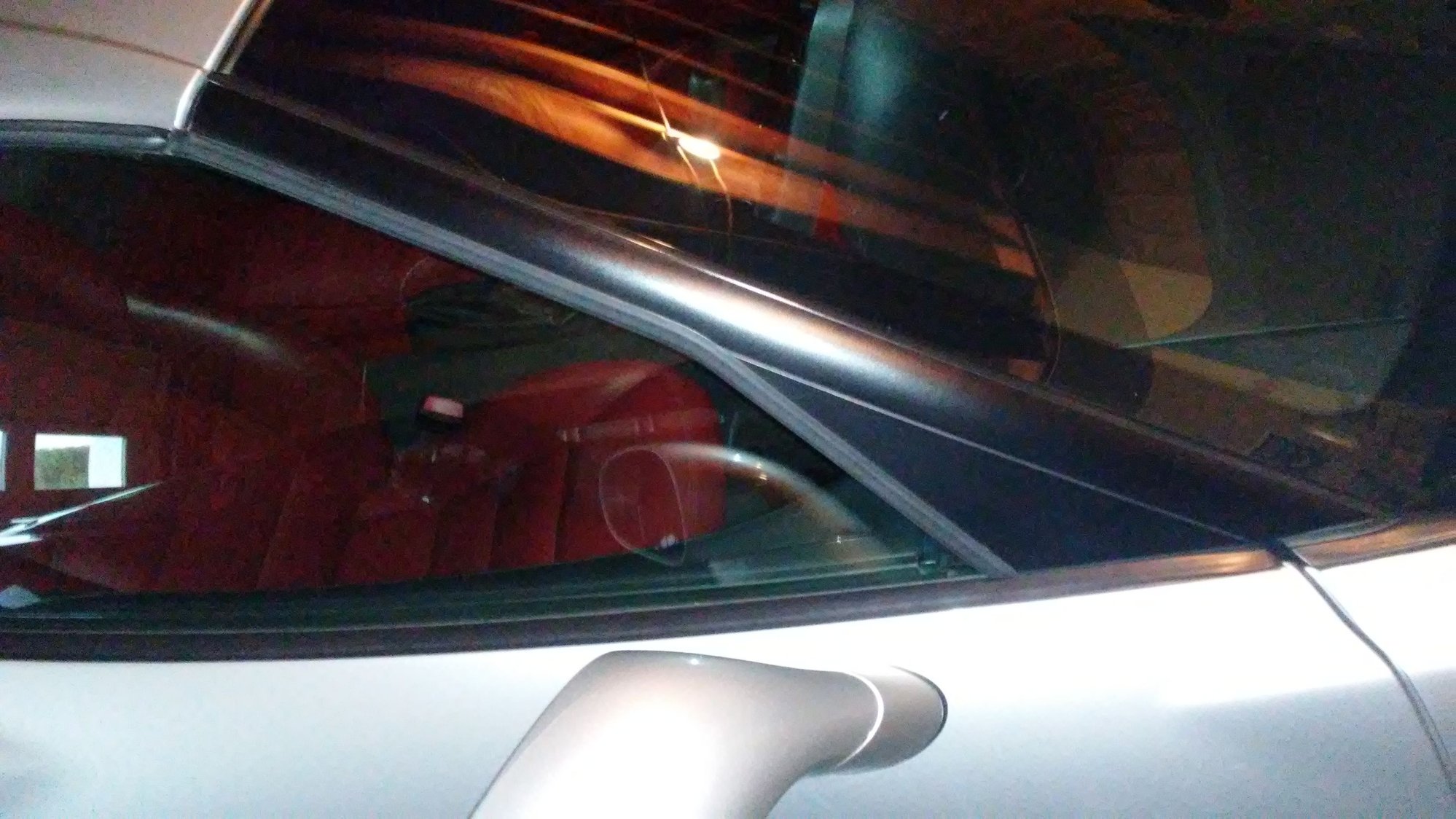

I just purchased a new windshield weatherstripping , how do I get this panel off on the side of the windshield?..Are there any how to videos on replacing the weatherstripping , I looked and couldn't find any...WW

Open the door.Screws are under weather stripping and any others are easy to see.Screw on bottom of A pillar applique

Here is a PDF of the process
File Type: pdf
