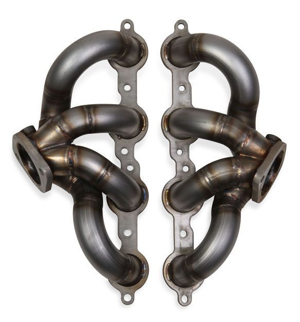

I am sure this has been brought up many times so forgive me but I am trying to find the easiest bolt on shorty headers that can reuse the cats and the rest of the current exhaust. I have read that it is not worth doing but I don't want the hassle or the expense of doing longtube headers. I want a little more sound and a better look under the hood. Have any of you done short tube headers and if so what brand did you use and was it an easy install? Thank you in advance for any replies

I added shorties back in year 2005...can't recall the brand, would have to research records.
At the same time I added Random Technologies Hi Flow cats.
Yes less weight and a slight tone change, bit no loudness change IMO.
I did the install in my garage...jacks stand height and header install mostly from the top.
Issues as I recall.
1) I made (outlined old ones and cut) exhaust gaskets from bulk gasket material as opposed to re-use or new OEM gaskets (new OEM many recommend). Also the donut gaskets should be replaced for a 100% job.
2) Some of the manifold and exhaust piping studs need a good soaking of Liquid Wrench or similar before removal.
3) Oil dip stick tube I recall was finicky (also could use a new o-ring) to install and one bolt (header to head) for this tube mount was difficult to access.
4) I don't recall a need to remove the tunnel plate for this install as loosening the catalytic convert section is accessible.
5) FWIW Jet Hot coating the headers before installation could be a good thing for extending life and a + for appearance.
Never the less...simple enough to DIY in your home garage.
Good luck

I installed last year the Hooker Black Heart short header that retains the factory cats, easy install 3-4 hours. I used them for the exact reasons you stated and have been very happy with them. Search shorty headers in this forum for info

We can supply you with the Hooker headers as mentioned above!

Please re-read the OP original post, he's not looking to make the most HP possible. He is simply looking for looks, easy install and cost, all a short tube header offers. I agree a Z06 manifold would be as good or better in the performance aspect but not in the looks dept. A short tube header will offer idle to mid rpm range performance over base manifolds, easy install and no tune. A long tube will absolutely make more power (with a tune) in the mid to high rpm range, but not where most of us daily drive.....so what's the point?

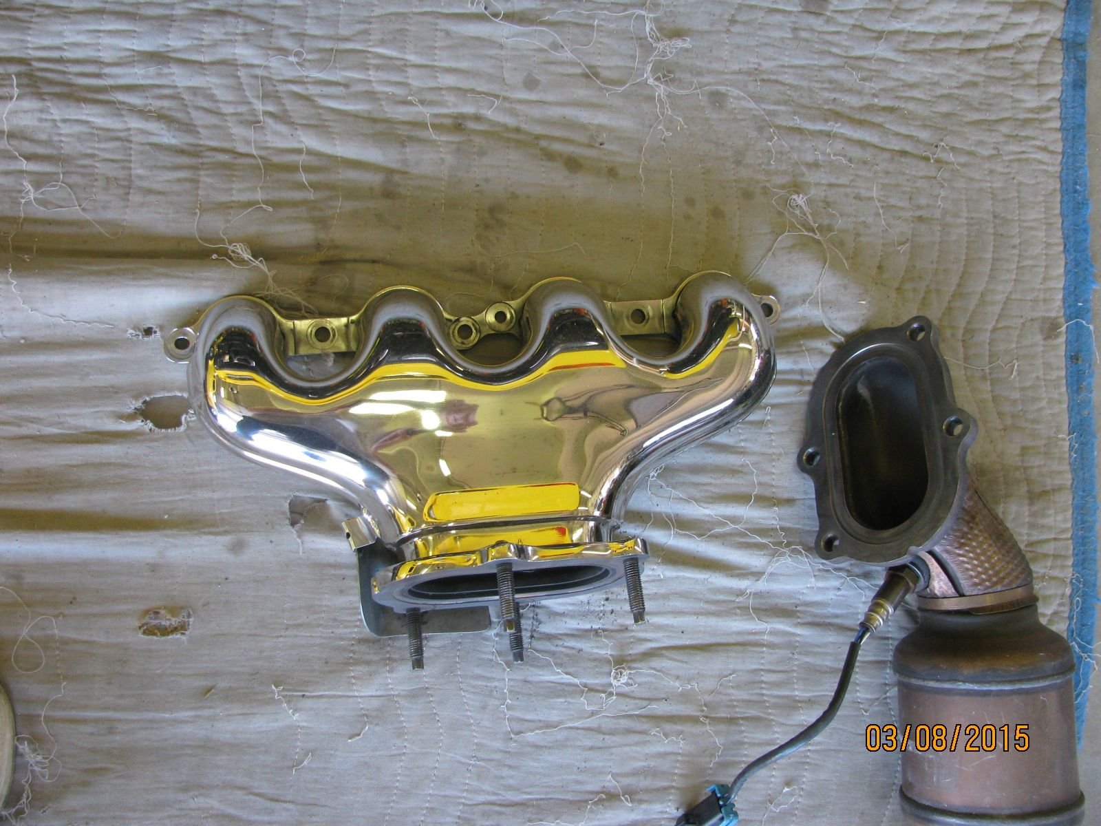

Originally Posted by MTPZ06
Go with LS7/LS9 manifolds/cats/midpipe setup instead.
About 70% of the power gain compared to long tubes and if you want underhood bling, just polish the stainless heatshield to a mirror finish.

I have these, but am still looking for a procedure to actually polish them like the picture. I have found 0 information.
You're looking in the wrong places or not looking very hard.
A Google/Yahoo search for "polishing stainless steel" brought up pages of info instantly.
