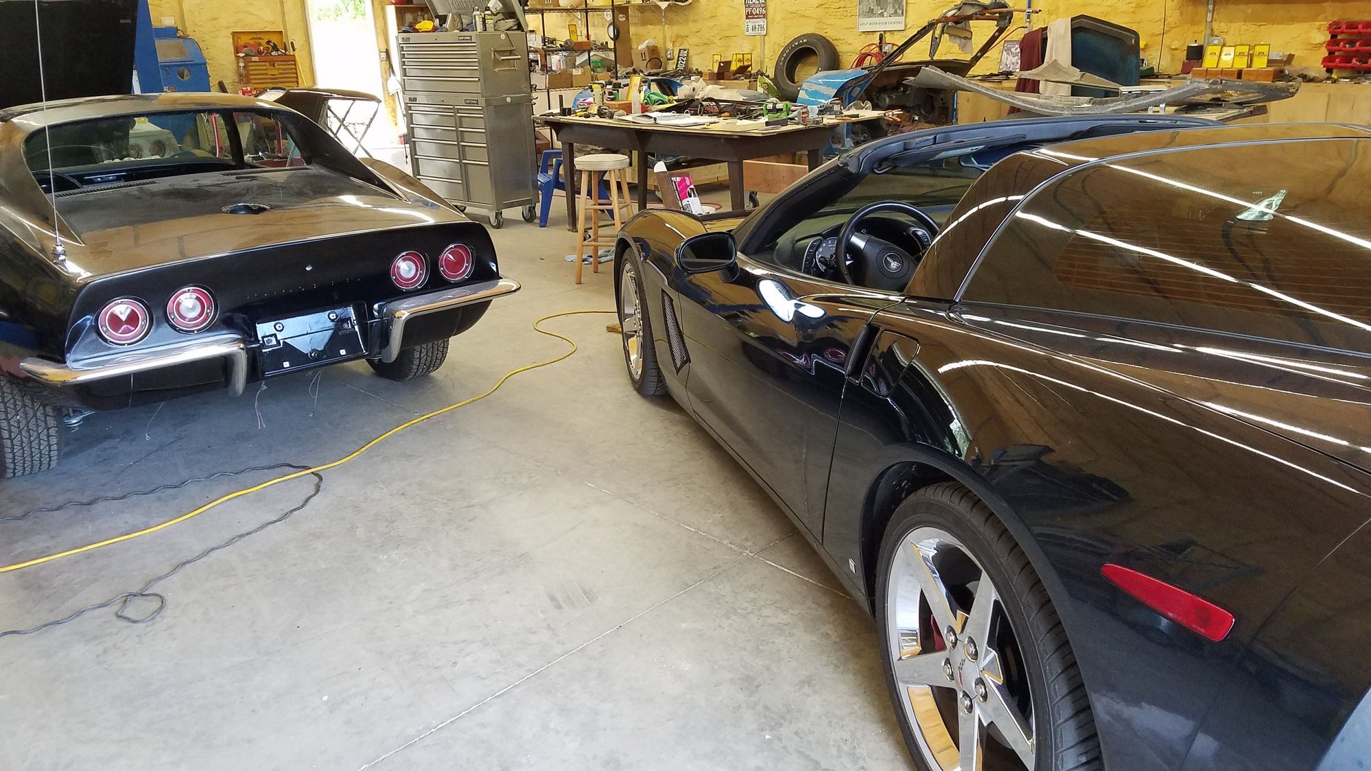

Brought the 07 down to my shop on my property and re torqued the axle nuts. Noticed that right brake caliper had some play in it. Adjusted that issue also. car is now fine. Thank you everyone for your help.
