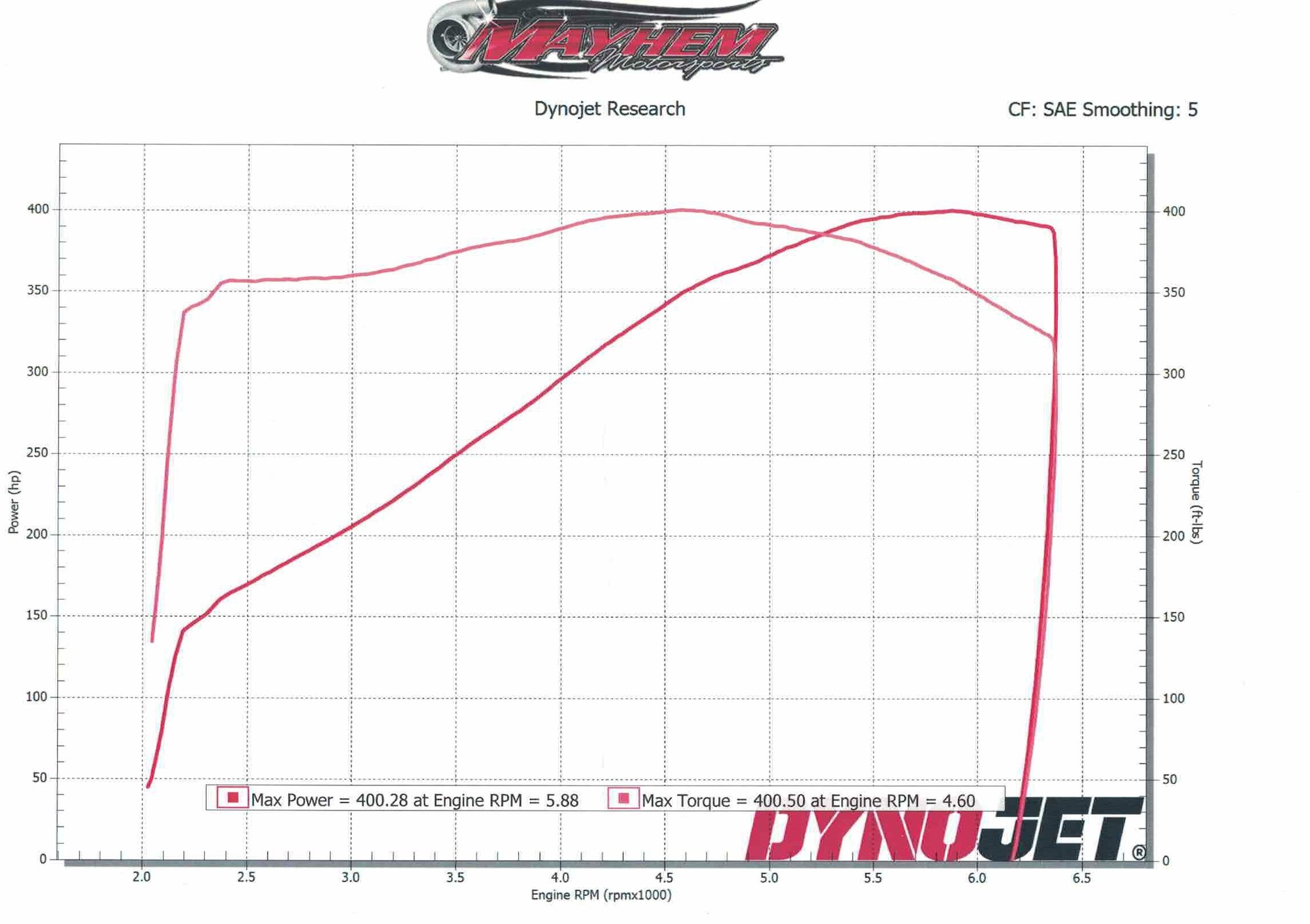

My 2006 Z51 M6 LS2 stock vs bolt-on's+dyno tune
Bolt-on's - LT 1-3/4" Headers (stainless works w/hi-flow cats), X-pipe, MSD Atomic Airforce Intake, Nick Williams 103mm polished TB, NGK TR55's, MSD Plug wires, Vararam CAI
It picked up 50HP and 55 ft-lbs of torque
I primarily track my car, the downside is that my oil temps were marginal before on 80+ deg days, I've got to get that dedicated oil cooler installed.
Of course, I like every bit of the upside
