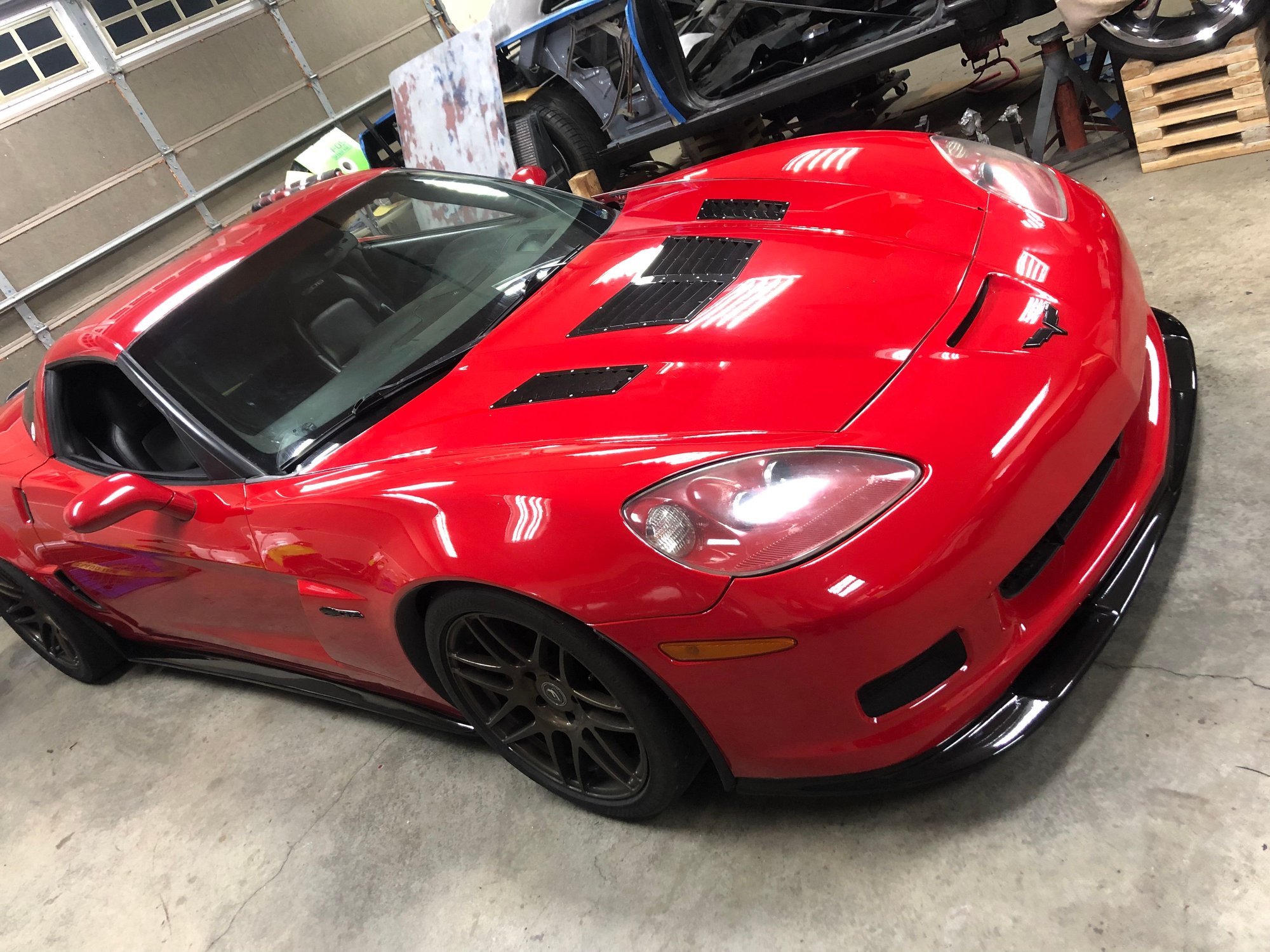

I know I’m not allowed to specifically mention vendors but I thought everyone should know there are far cheaper options for hood louvers then the regular vendor everyone uses. I did have to assemble them and paint them myself but it wasn’t very hard and I think they turned out awesome. This guy just cuts them and ships them flat. Am I allowed to say the company name or not?

So how scary is it cutting huge holes in your hood?
What did you use to cut the hood?
They look good on your car :-)

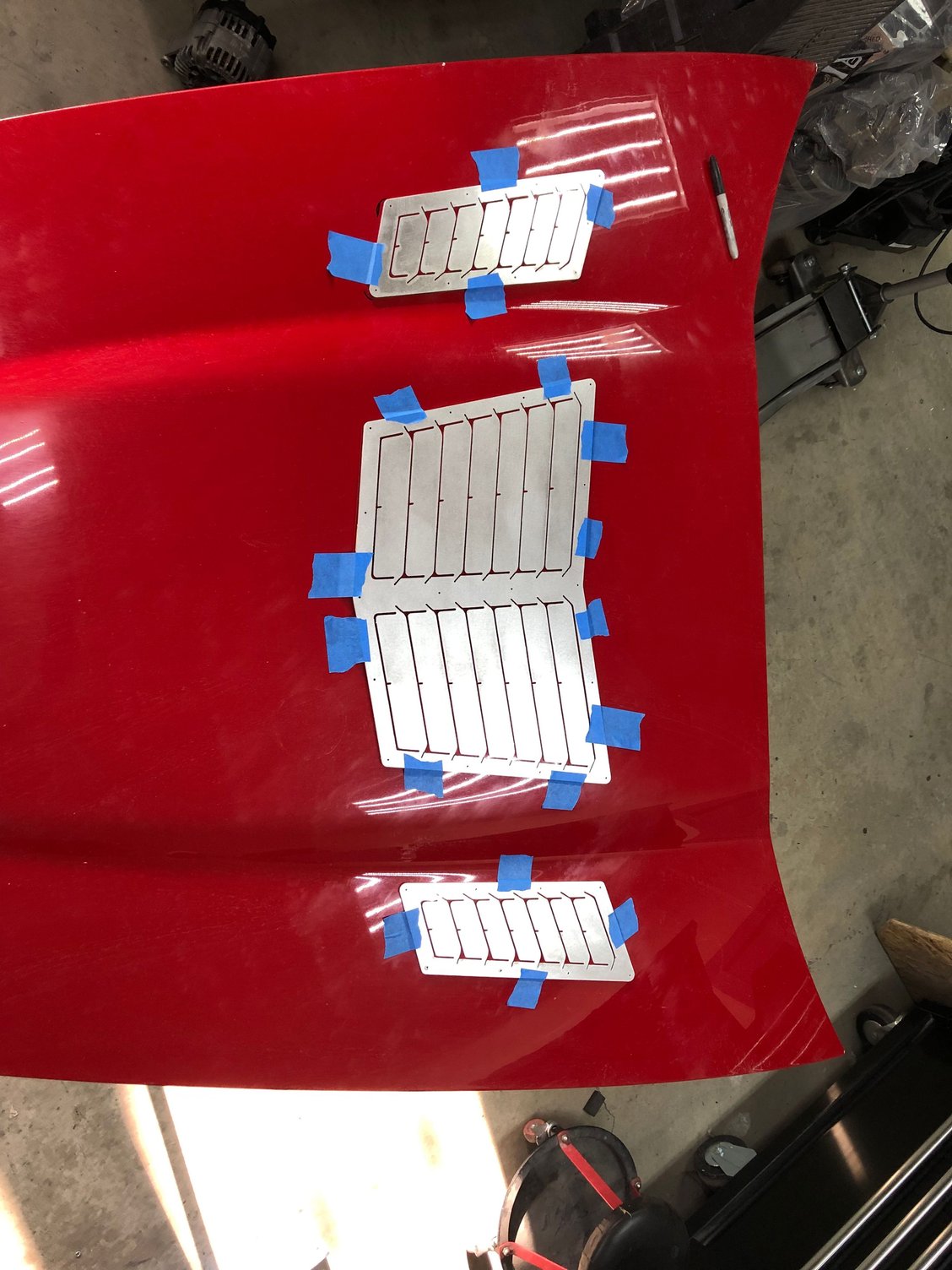

How does the center brace stay in place once you bent the louvers? Is it held by rivets?

Since they ship flat it wasn’t to bad to lay them on the hood and tape lines for the holes. I just used a high speed with a cut off wheel and an air saw for the rounded corners. Holding them in place to drill the holes for the rivets is a little tricky. But if you put one or two rivets to hold it in place while you drill the rest it’s not to bad.

What holds the center rib to the bottom of the angled louvers? I see slits in the center rib to locate the louvers, but do you glue them together, tack them together?
