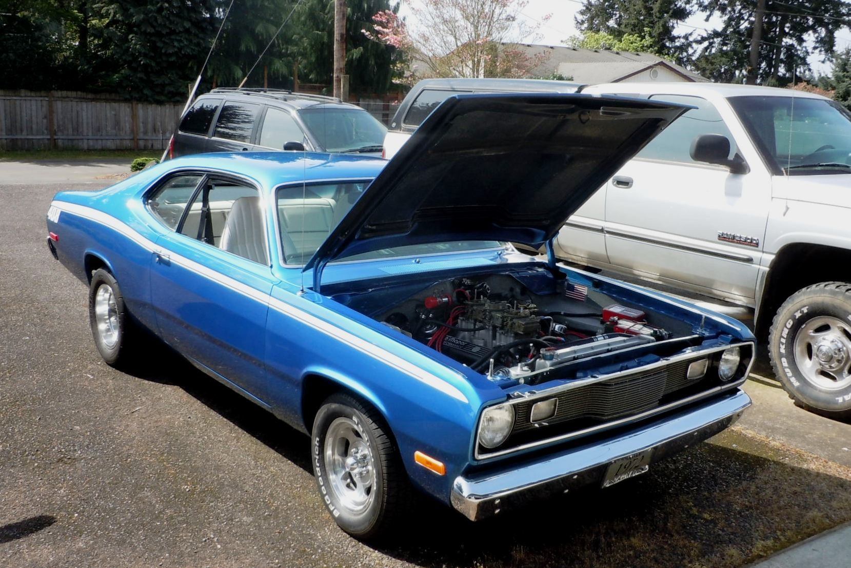

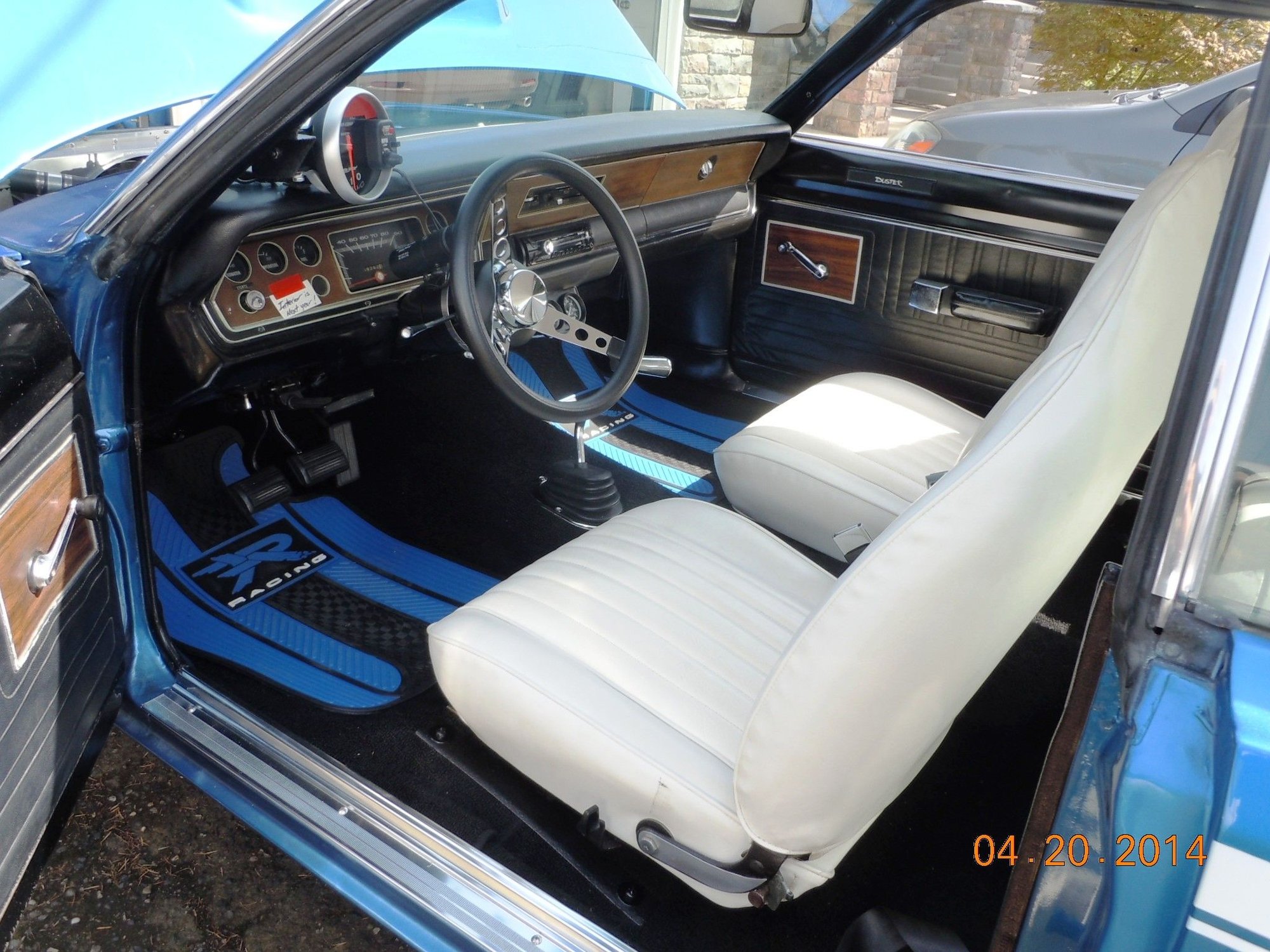

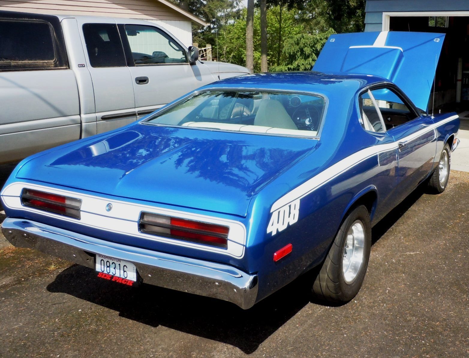

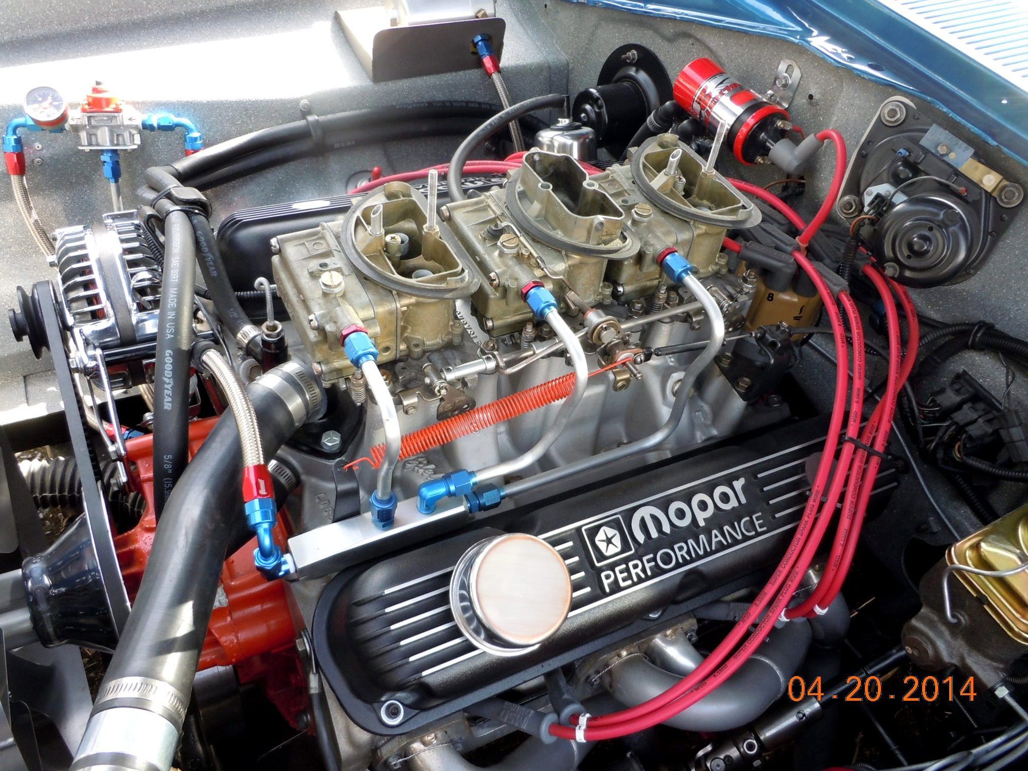

Oh & BTW - I need to sell my just finished project to help finance my new Vette - here are a few pics.
1972 Plymouth Duster
Very nice graphics
Nope it no Corvette, ha...
408 Stroker, dyno'd 529 hp 514 Tq at the crank. Nice lil eye catch'n streeter.

Welcome to the forum. There's more than a few of us "seasoned" members around here. Nice Duster you have there. What are those funny looking things on top of your engine? My '69 Camaro has just one big one.
