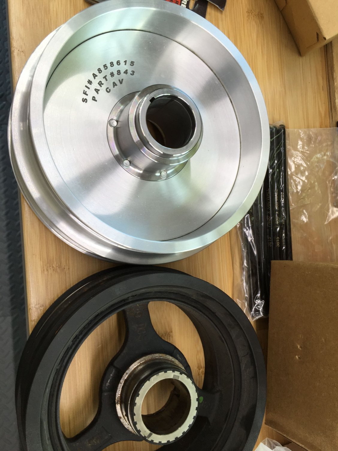

This sounds weird. I can understand your frustration with having to pull that damn rack and all the other **** off just to get the balancer off several times. I’ve never heard of an IW balancer that had a machining issue, but there’s always a first time.
I’m just guessing at this stage, but are you sure that by chance they didn’t mistakenly ship you the “Blower Hub” version with the oversized seal and that is what is destroying the seal when you install the balancer? The oversized blower hub balancer ships with its own OD seal, which is considerably larger than the stock one. Im not sure that you can even get the oversized hub through the seal, but if you did, for sure it would destroy the seal.
Here’s a picture of my IW balancer with the oversized blower hub, sitting next to the stock balancer:

If new balancer has a keyway cut in it like the one posted above by CI GS, it needs to be sealed with some rtv or it can leak.
Did not read all the posts, somebody might have mentioned this already, was just throwing this out there.
