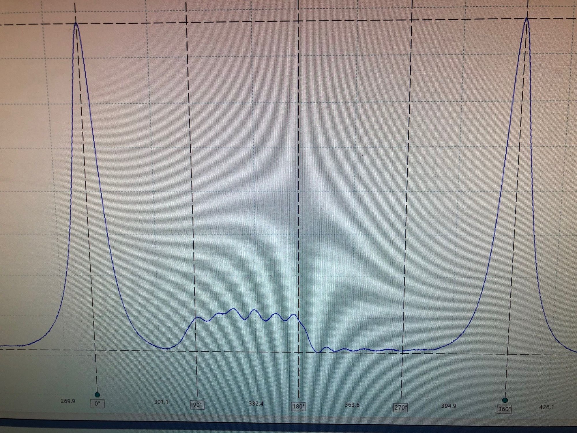

Just noticed that you said you have 14 inches of vacuum at idle...is this a stock engine ??...14 seems a low...my LS1 hovers between 20-21 inches at idle !!...also since you swapped out the injectors did you check them "electrically" ??...if you have good spark at 7 and 8 I'd start focusing on mechanical...if you can find a shop that knows how to do an in cylinder pressure analysis you can rule out any mechanical or breathing problems with the engine...I just started doing this myself and just want to get more experience with the waveform analysis...here is what you would be looking at...my 2001 engine at idle...no fuel or spark so you're just looking at the engine as an air pump !!!...looking at TDC, exhaust valve opening and intake valve closing.
