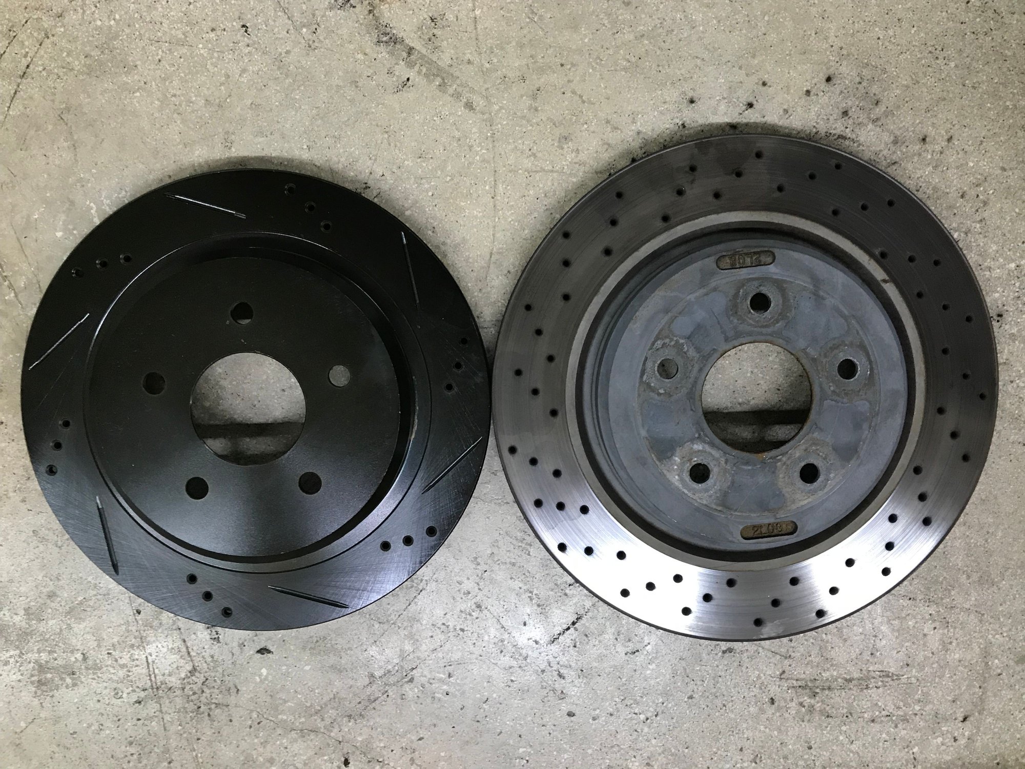

You would have to speak to Carlyle to see if the offset of their rotor is the same as the stock rotor, and, if so, then it may be possible to cut your rotors down and use them. I doubt that it would be worth the trouble though. I didn’t actually check the offset or measure the difference in diameter when I did the swap myself, but I can tell you that the difference in weight of the stock rotor to the Carlyle rotor is: exactly 6.3 lbs. the stock rotor weighs 20 lbs and the Carlyle weighs 13.3 lbs.
Here’s a few pictures from when I ddI the install on my car:
Big difference in diameter
Carlyle rotor = 13.3 lbs
Stock GS/ZO6 rotor = 20 lbs
