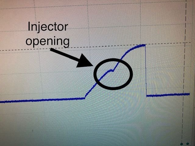

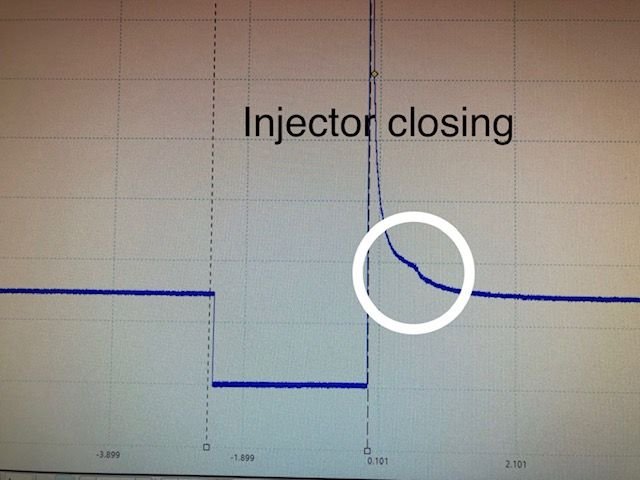

May be a “mechanical” issue...broken valve spring, valves etc...rent yourself a compression gauge from an auto parts store and see what you have !!!...you can do a “cranking compression test” by listening to the engine crank...should sound the same on every crank...you do it by doing a “clear flood crank”...gas pedal to the floor and crank the engine over !!....and as far as the new injector did you check for power and that the PCM is grounding it...can be tested with a 12 volt test light connected to battery positive or a “noid” light !!

Don't know if you did this to check for spark just pull the plug wire off the coil pack and see if the spark jumps between the 2...now if it is intermittent you would really need a scope to check that out...to check the injector first unplug it and see if you have system voltage on the pink wire...now take a 12 volt test light connected to battery POSITIVE...the injector circuit is "ground side switched"...means the PCM is grounding the injector circuit...now with the engine running probe the other injector wire...if the PCM is grounding that circuit the test light will DIMLY blink...might be easier to see when it's a little dark outside !!...when I scope the injector circuit I look at both injector voltage and current waveforms (see pics)
...it tells a lot but without specialized equipment you'll only be changing or swapping parts !!...and BTW my LS1 draws about 21 in/hg of vacuum at idle...17 seems a little low....and yes I would still do a compression test and try the clear flood crank and listen for cranking inconsistencies !!
