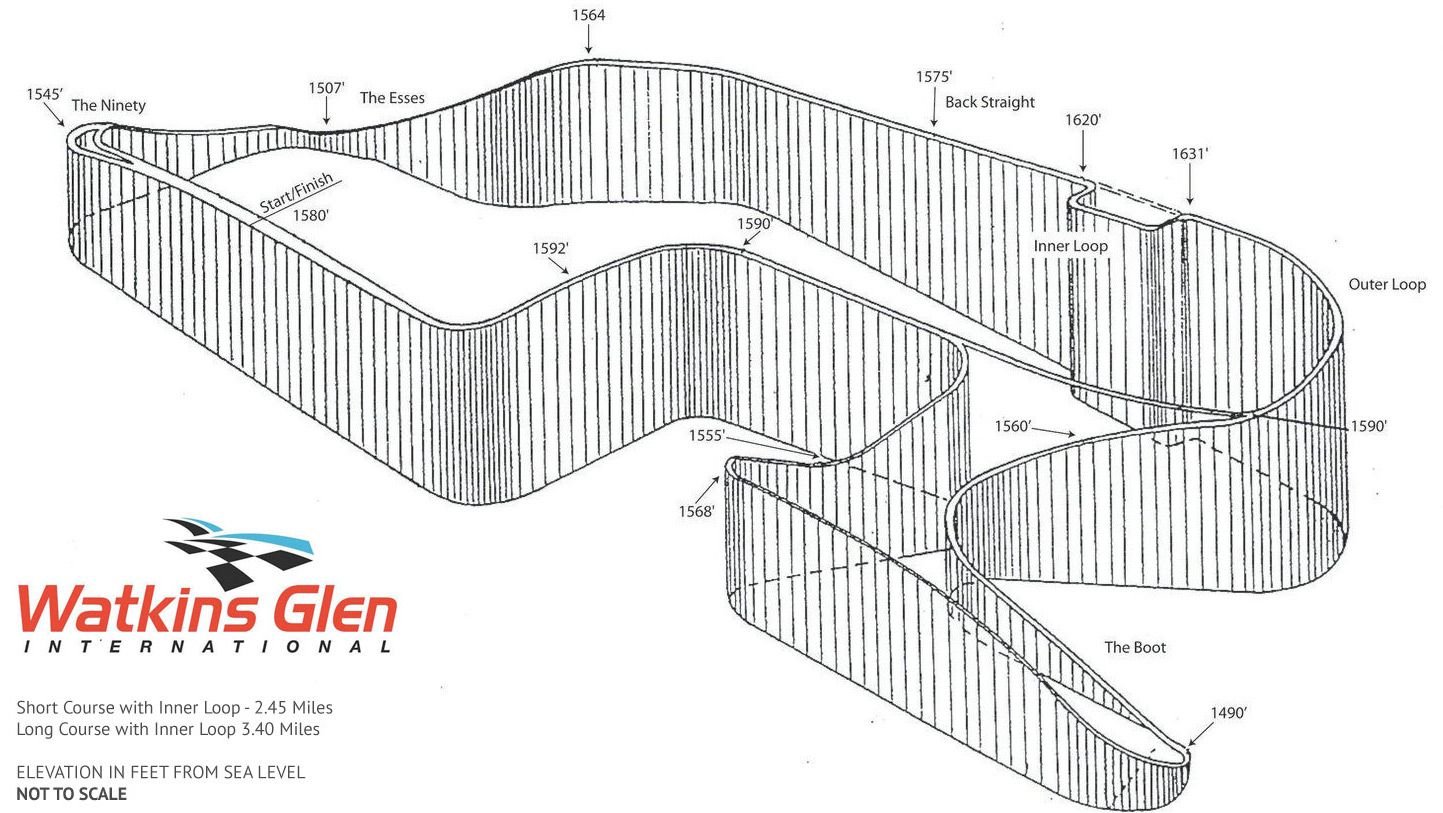

I have literally thousands and thousands of laps at the Glen and race and instruct there. There is no quick and easy fix to your issue, but there are things you can do. The "floaty" feeling is a combination of loss of aerodynamic downforce as you reach the top of the esses, a shift in weight and your suspension's inability to compensate for it. From the bottom of the esses, to the top of the esses, there is a change (increase) in elevation of 57' and then another 10' in rise to the back straight. The car, without enough downforce, needs a moment to settle as it crests the esses, as it will want to "float".
A vented hood, while certainly a benefit, will not cure this issue at this particular spot on the track. _BlueZ06_ is correct in what he said. More aerodynamic downforce is needed to keep the car planted (front splitter and rear spolier), and a better set of shocks (like DRM valved Bilsteins) or coilovers. Typically, you should be WOT at that point (and far before it) to get to Vmax asap and keep the weight shifted to the rear as you come out of the Esses and hit the back straight. If you feel "floaty" then you need to breathe the throttle to help shift the weight back to the front to create some mechanical grip at the front and help settle the car.
Take a look at the attached and this will help you understand why this is happening.

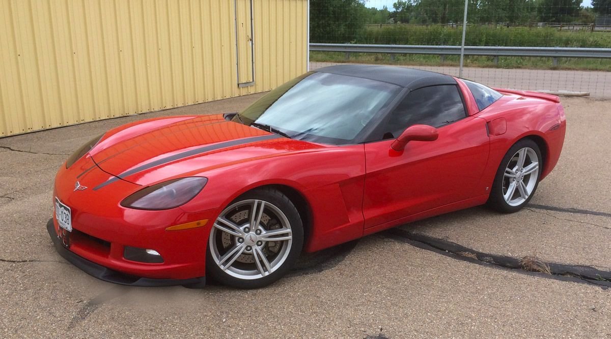

I found that installing a Front Splitter and Z51 style Rear Spoiler to be quick and easy. I would think these are much easier than changing out the Hood. I don't know "how much" Splitter & Spoiler effectiveness is required for your needs. On ebay "theSpoilerCompany" offers the rear spoiler for about $250, IIRC. And the Splitter I also purchased on ebay was only about $150. Both were very easy to install. The Front Splitter required screws ... in areas that were already scuffed & scratched from scraping the pavement. The Rear Spoiler did not require holes drilled for screws, as it uses Very High Bond (VHB) 3M adhesive tapes.

vezePilot, thanks and those look nice. I'm probably over thinking it but was hesitant to add aero unless it was a complete package that was tested like using all GM parts from a GS or ZO6. I worry about too much on the rear which lift the front or worse would be having too much on the front and having the back come around at speed which in a Corvette is something you don't want to do more than once if at all. Your's does look nice and for the price, it could be worth trying.
