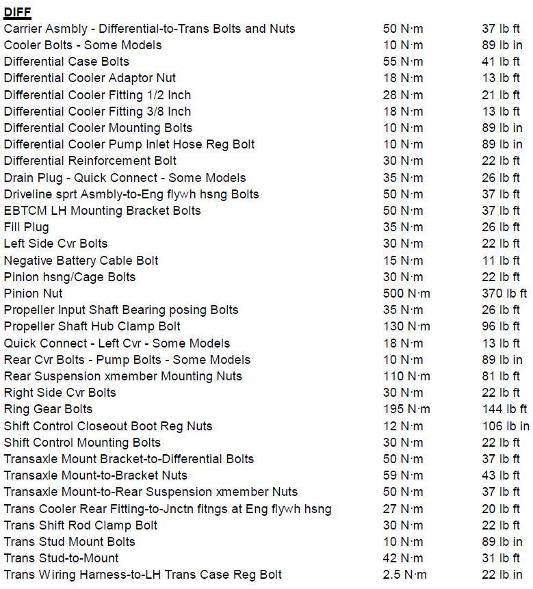

I double checked my shop manual and found a spec of 22 ft-lbs for the "differential reinforcement bolts".....is that what they call the bolts that connect the differential cover to the differential housing? Just checking to make sure we're talking about the same bolts. If we are, makes one wonder why they just can't describe the bolts more "directly" than "reinforcement bolts"......Thanks, again.....

Hope this helps Both left & right side "Cvr" bolts look to be 22 lb/ft

Thanks....I appreciate all the other specs as well.....
