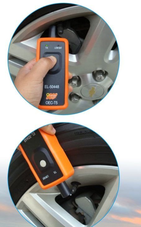

Let them try or buy a tpms tool from amazon for $10.

Yes, they are available at Walmart or amazon for $10.00 I've had one for years, and it works like a charm.

Wouldn't the tool be able to read if there was a sensor there even if it was the wrong one? He told me he had it set to read if there was one there and it told him "non available"
I decided to order one of the cheap relearn tools to see if I could maybe do a better job of getting them to read if not Im just going to order OEM replacement and have them added/changed from what ever is in there

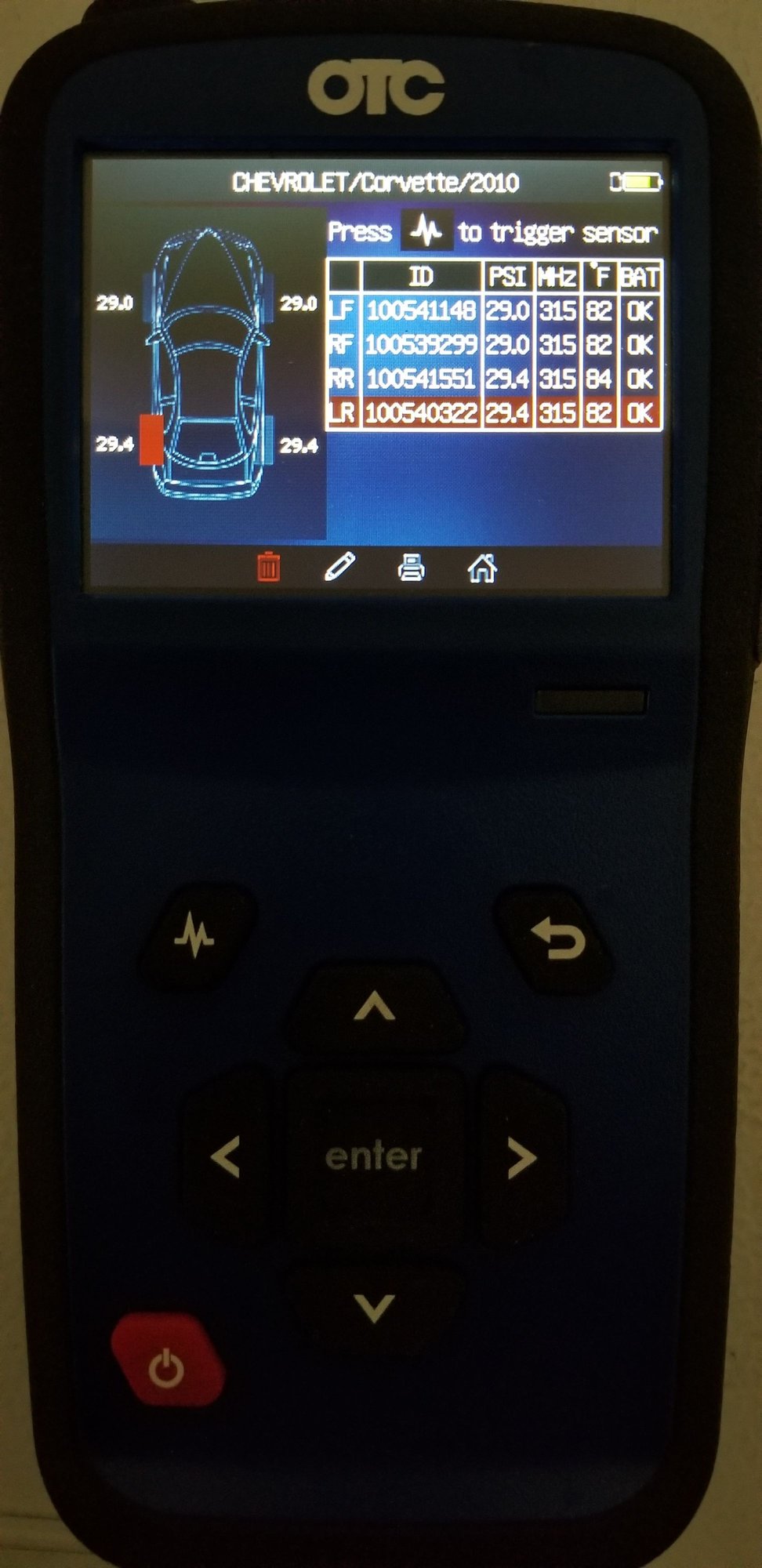

Find a tire or service store with a real TPMS tester. Such as the OTC 3838
It will show you frequency, temp, battery level, tire pressure, serial number.

I got my TPMS tool today and nothing. Cant get them to register. I have to assume at this point they are either 2005-2009 sensors or there are no sensors installed. Looks like ill be getting some new ones.

Final update. I got the new GM TPMS in and the learn tool I got from Amazon wouldn't recognize them. Took the car to a trusted Pep Boys location and their tool instantly recognized the new sensors un mounted and still couldn't get the old one to read. Swapped them out and all is good now.
