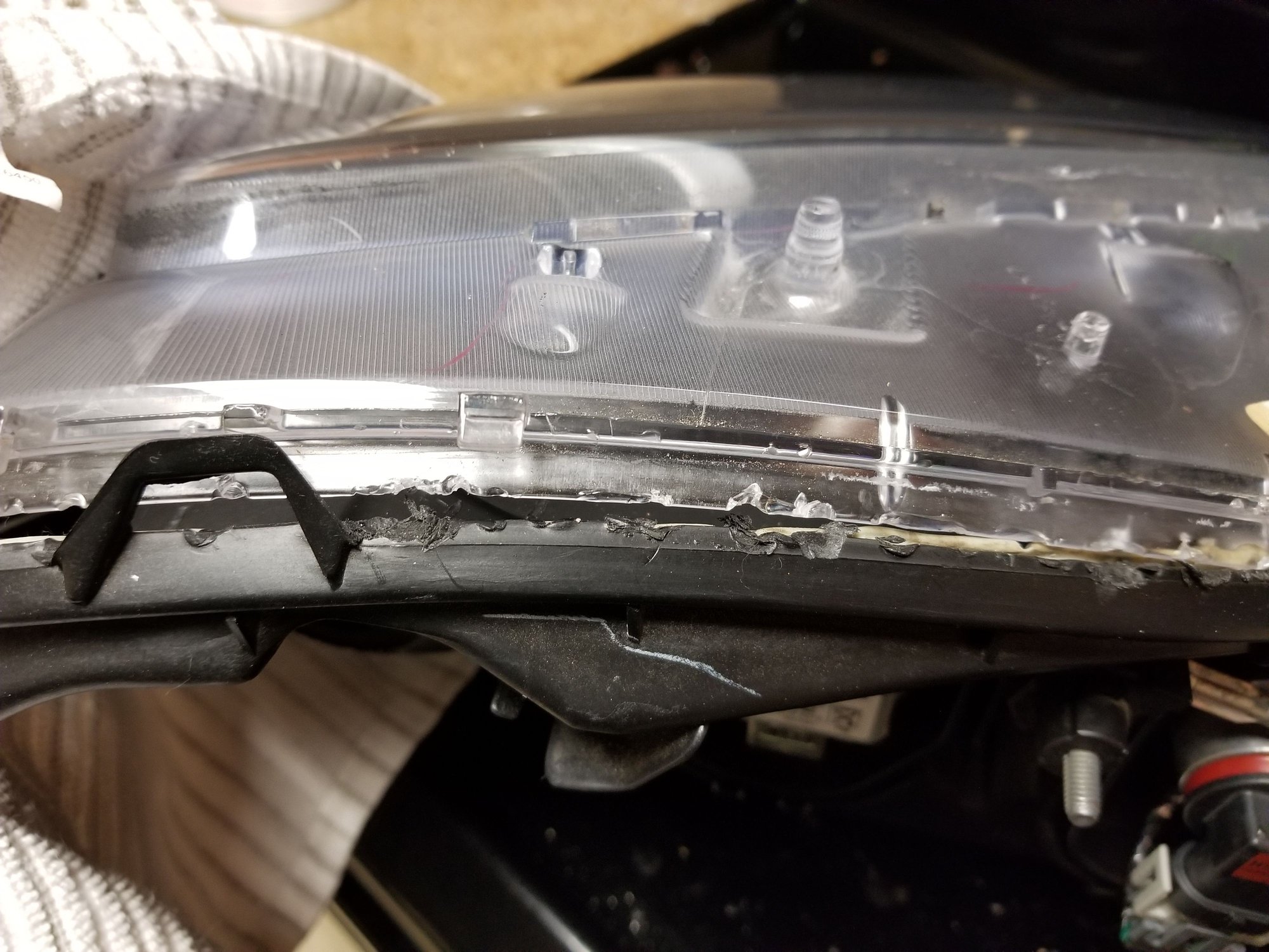

Hi guys,
I was trying to replace the headlight lenses myself according to the posts/documents I have found on the forums. I have gotten part of the way through the first headlight lens but can't seem to get any more of it apart. I feel like I might be missing something because with plastic prying tools, I am unable to slide them down to keep it coming apart but with screwdrivers, the plastic is too soft and is deforming badly, plus I can't seem to get more of it apart. I have had them sit in the oven at 225 degrees for 15 mins before I work on them each time. Here is picture of what I have been able to do and you can see how badly it is deforming the plastic.
Does anyone have any suggestions to help with this?

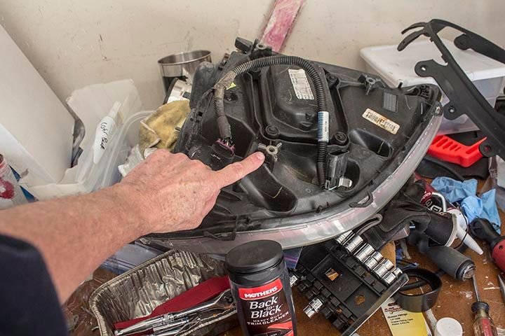

Yes the bolts are threaded into the "black" plastic part of the lens. It looks something like a wood screw so if you have turned them a few times they are probably close to being stripped. The original and replacement lenses have no bolts at all, they are glued to the black plastic.
Here are some pictures I took a couple of years ago. I take lots of pictures when I work on my car because I can't remember s**t otherwise:
Bolts are removed here from the bottom of the light. Here is one of locations
