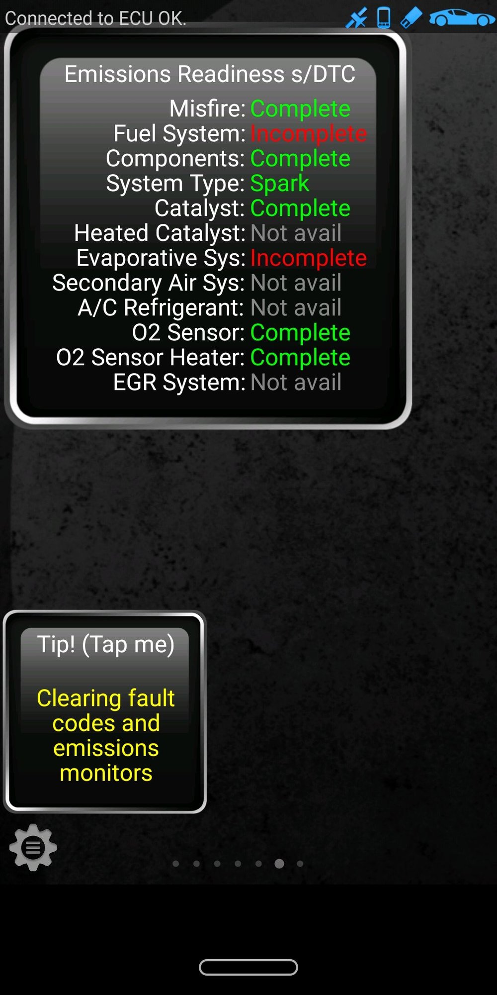

Unfortunately I don't. This is what I got using the Torque App.

I just went through NJ Inspection and ALL my monitors were set the night before I took it because my battery was disconnected...you can have 1 not complete and still pass Inspection and the hardest one to set is EVAP...on my C5 the fuel has to be between 1/4 to 3/4 of a tank !!...and you can't have even pending DTC's or it won't set...luckily I have a few scan tools and I used my Tech 2 and took 5 minutes to run the EVAP test using the "Service Bay" test. Cruise up to Monmouth County and I'll take care of it for you...LOL !!!...I don't remember what sets the Fuel System monitor.

If you don't have any pending or current EVAP DTC's I wouldn't fire the parts canon and change the purge valve...like I said the EVAP is the hardest monitor to set and you can drive for weeks and it not set !!...any bi directional scan tool will work...I would have him do the Service Bay Test first !!

C5 Diag is Correct !!! NJ Inspection will allow you to pass with one monitor showing incomplete but two or more is going to be a failure.
No guarantee that even a Tech II will be able to get the Evap to run - it's typically the hardest to get to reset.
You can try just driving the car for a while - the odds of being pulled over for an expired sticker are quite "low"
