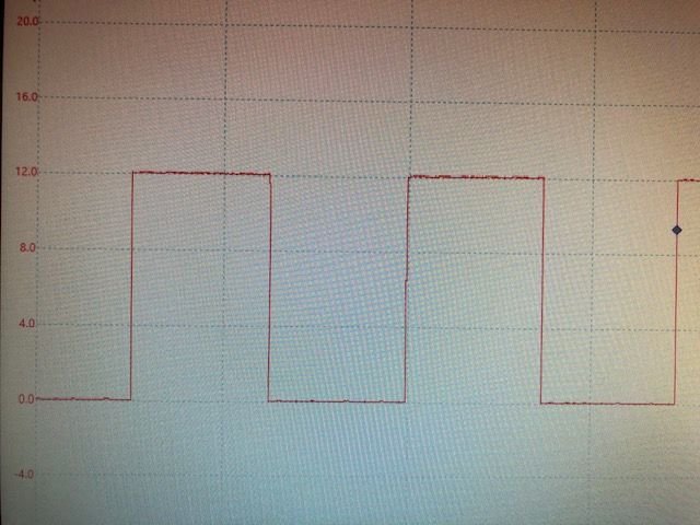

Without a "pinpoint test" using a DSO (digital storage oscilloscope) one would only be "guessing" as to the correct diagnosis as I am...these Hall Effect sensors will sometimes fail gradually or suddenly...the waveform pictured below is from my cam sensor which is a 1X...a 0-12 volt square wave...now the car will start without a cam sensor signal although it will take a little longer but without a crank sensor signal the the will not start

I think you are right but mine was crankiiiiiing but no start at all
Since I changed the cam sensor -> no more problem (until the pump harness failed ofc)
