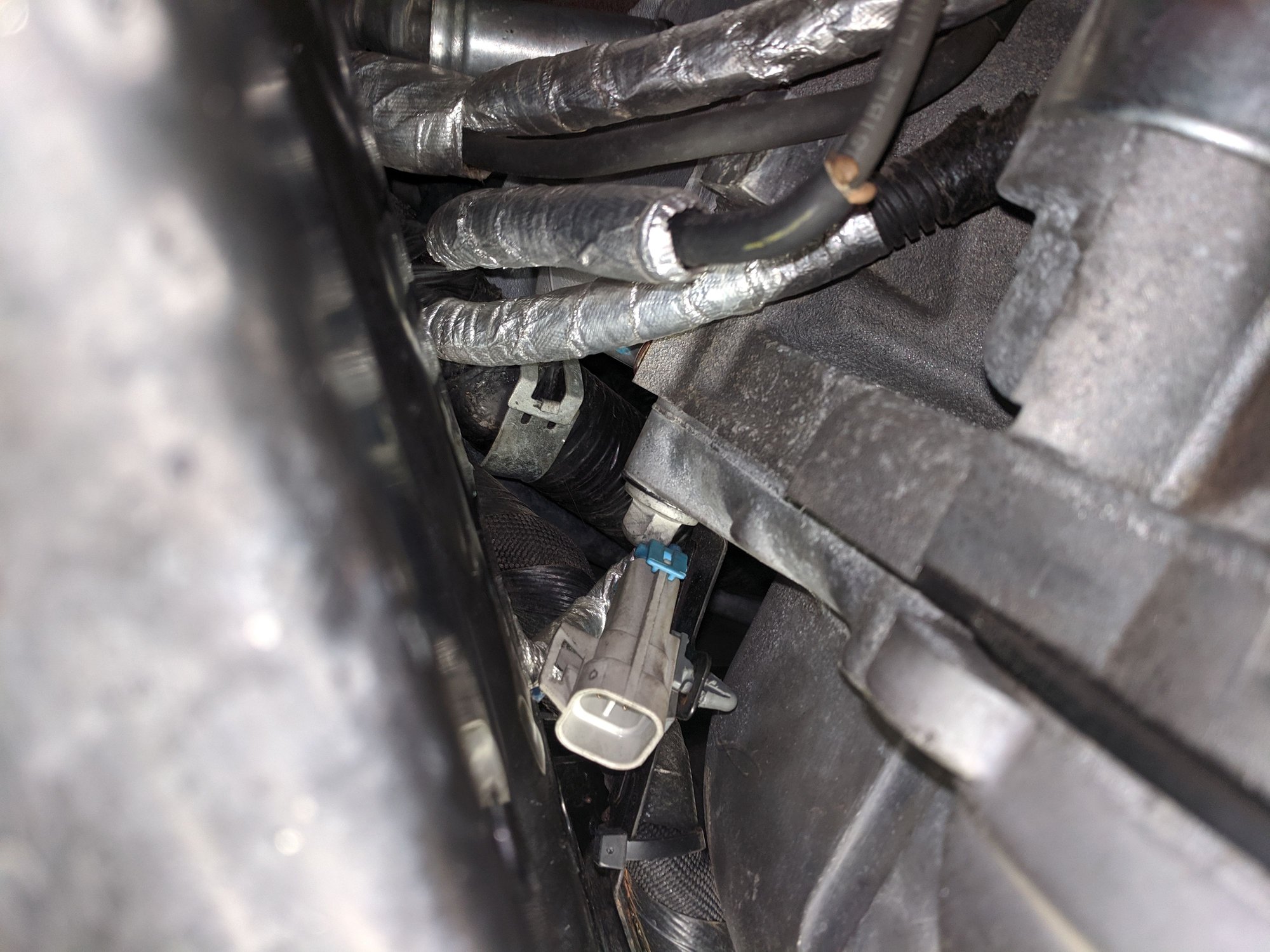

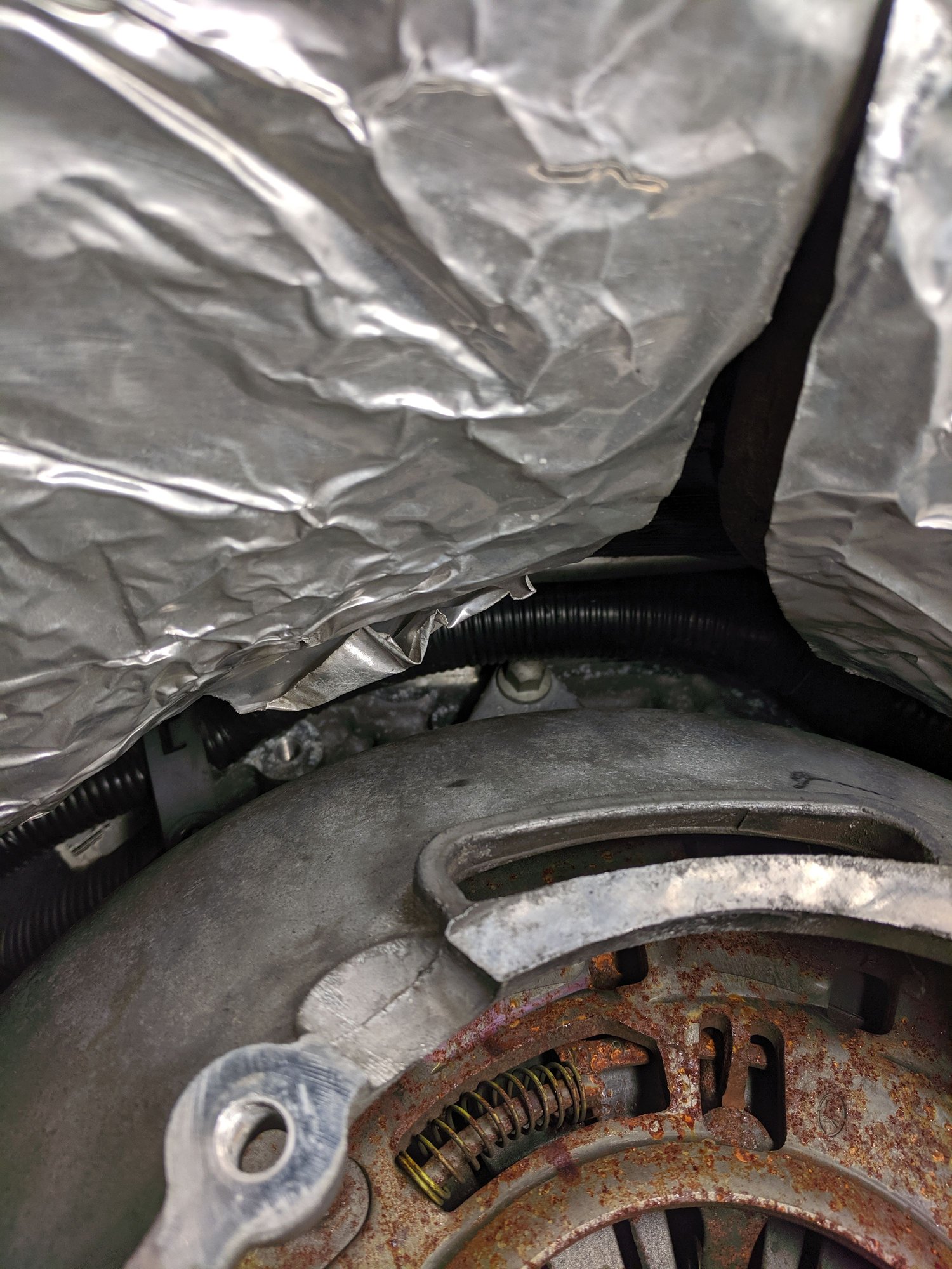

I can't manage to reach the 12 o'clock bolt on the bellhousing. I've got every other bolt removed aside from 12 and 2 o'clock positions. I lowered the front sway bar, loosened the front cradle nuts so that they are threaded but loose, loosened the engine mount nuts (but haven't removed them). This was all in an attempt to give the engine some wiggle room or flex to access the 12 o'clock bolt. It doesn't really look like the engine moved at all when I loosened the cradle. I just left it for the night. As for the 2 o'clock, the O2 sensor connector is in the way and attached to a bracket bolted to the bellhousing. This one, I can't even fit a socket on. How in the hell am I supposed to get that off?mAny tips? Here are some pics.

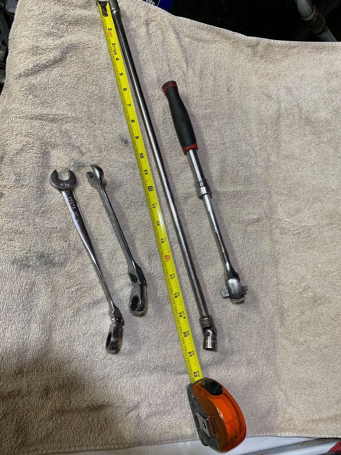

The way I do the side upper bell housing bolts is with a 3/8 extension 20/24” long and a swivel socket using an extra long ratchet, the upper bolts are best done with a flex ratcheting wrench you don’t even have to see em just put the wrench on it and ratchet it off.

This and lowering the front cradle as much as possible (leave enough for all bolt threads to be engaged) you should have no problem. My rule of thumb is it you can see it you can get it loose. From your picture you can see it.

Fair enough! I definitely have the extensions and swivel sockets out. They helped me get the first several bolts. The ratcheting open-ended wrench might be what gets the 2 o'clock bolt out, and that flex head wrench for the 12. I don't feel like the cradle really moved all that much when loosened. I'll give it another go tomorrow.

That flex ratcheting wrench looks like the truth. Gonna have to locate some.
