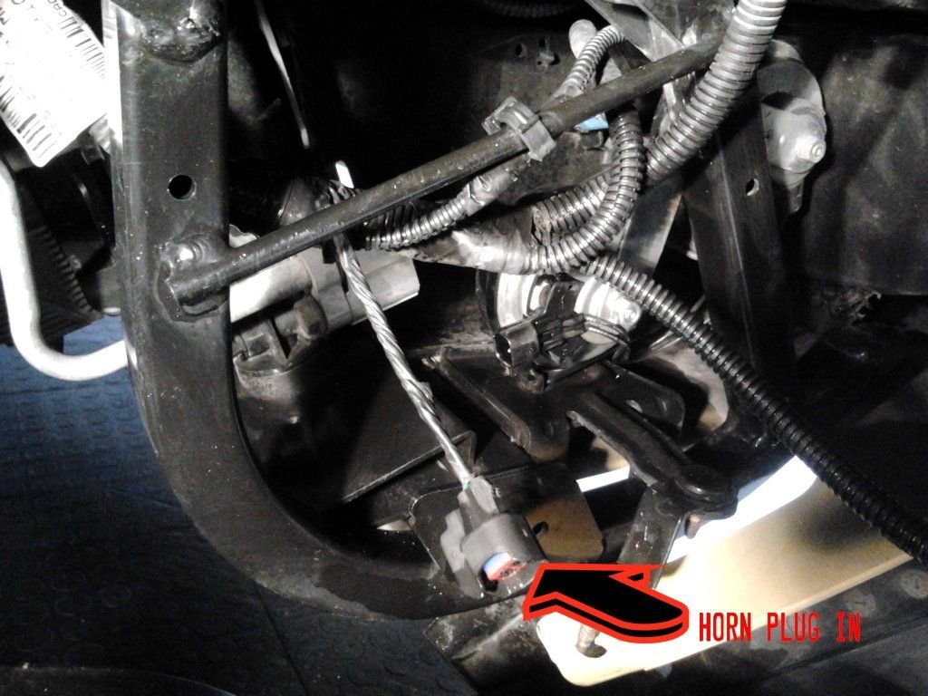

Putting back a C6 that my buddy owned. On the front passenger side, right on the radiator support. There are 4 plugs. One is for the fog and the other is for the side marker. That leaves two unknown plugs.
What do they go to?
Thanks!

There should be 2 in that area for ambient air temperature sensor and the horn or possibly under hood lamp

The plugs that are hanging don't look like its for the ambient temp sensor however. One may go to the horn, the other for the underhood light, even if it doesn't have one, the plug is still attached near the top of the radiator on passenger side.
Horn plug

the front radiator support got pulled out from a accident, so had to replace alot of things in the front.
Thank you for the pictures! Great help!
