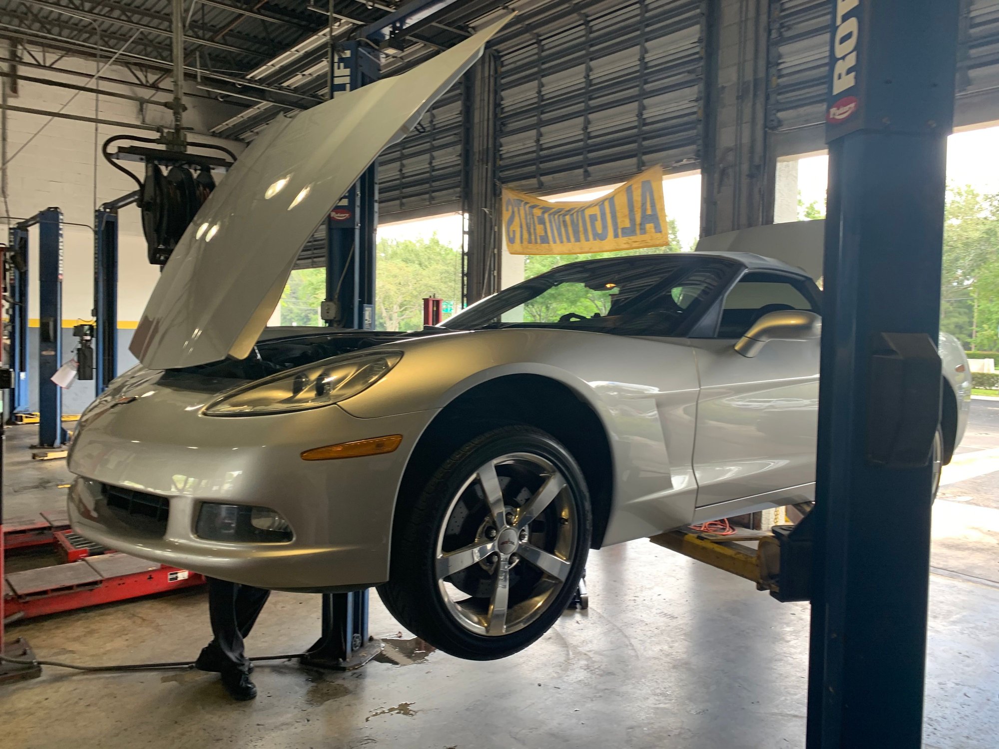

I have a popping sound coming from the front of my C6, I want to replace the shocks, but I'm told I need the $455 a piece ones, ouch! (Is that Magna Ride?)
Question is can I replace the expensive ones with a pair of standard ones? I'm guessing I will lose the sport/street setting, but maybe since I've never even used it I wont miss it.

I had the car on a rack yesterday and could tell the upper control arm was slightly bent and making contact wit the shock. I am replacing the upper and lower control arms and thought I would do the shock too. Not realizing all 4 would need to be swapped over.
I am convinced that I will keep the system in place and simply buy the replacement shock if the noise isn't remedied by the control arm replacement. The height adjuster pad is worn unevenly too.
I have an 08 6.2 4LT with 49,000 on the odo. Truthfully I know it was in a front end collision just prior to me buying it, where the air bags did not deploy, I knew this going into the purchase, and I'm okay with that.

We checked all sway bar links and bushes, at full droop and compressed.

it's entirely normal for the upper control arm to come into contact with the shock when the car is on a lift and the suspension is hanging.
I hope you're not replacing control arms for this reason alone, because you're going to be sadly disappointed after you're done and it still hits the shock when the suspension is hanging.

99 times out of 100, it's the end links on the sway bar. $50 each. Sounds like the OP just tossed a bunch of money away

Popping sounds are sway links. Disconnect them and drive a bit to verify. They generally need replaced about every 50K miles if you drive more than just locally. About $25-35 each from online dealers.
BTW, the ride height pads are not available from the dealer except as part of a spring assembly. If you feel the need to replace them, use aftermarket parts from Corvette Central. They will be a little larger than OEM on the front, but identical size as rears.
