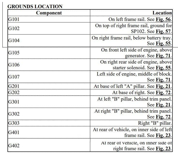

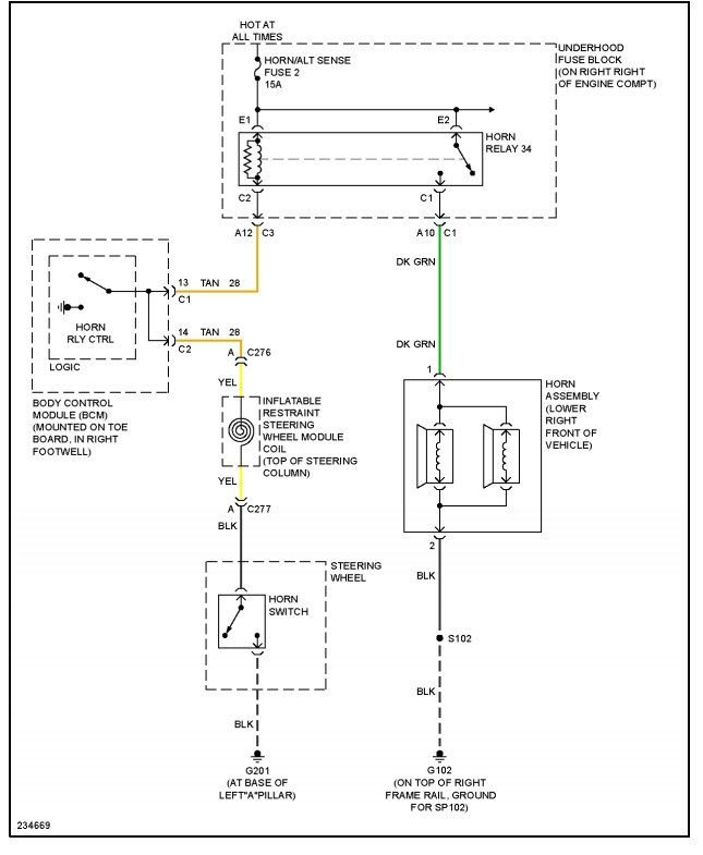

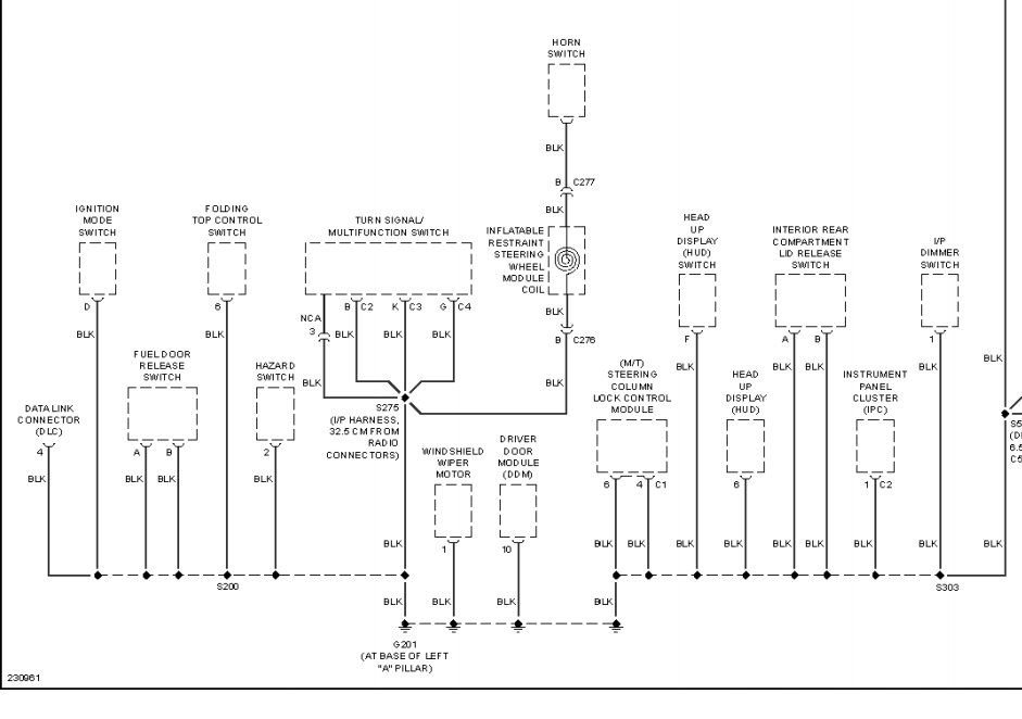

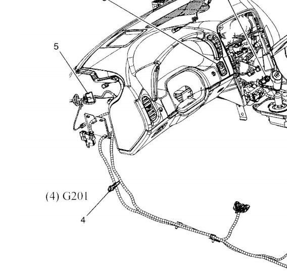

Normally, when this type of stuff happens, it's associated with a ground or grounds. The C6 electrical system is ground activated, so if a ground is not making good contact, strange stuff happens.
I'm not saying it is a grounding issue, but you may want to check, remove clean, and put dielectric grease on those grounds to assure that is not the issue.
I've attached a few electrical diagrams (parts) that show the grounding of the horn/function switch and horn.
