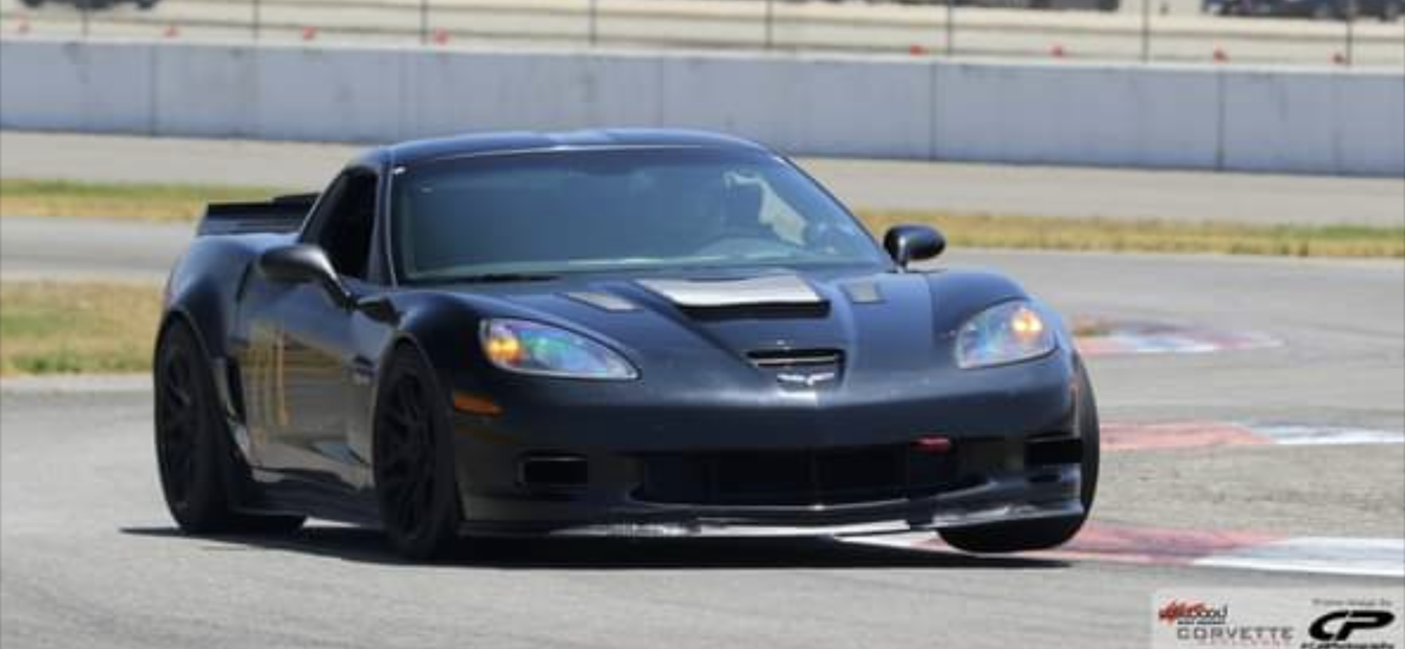

DIY Foglight Mod
Old May 22, 2023 | 01:01 PM
Aardwolf's Avatar
Aardwolf
Joined: Jun 2004
Posts: 13,939
Likes: 705
From: WI
Yeah love that mod they did great.

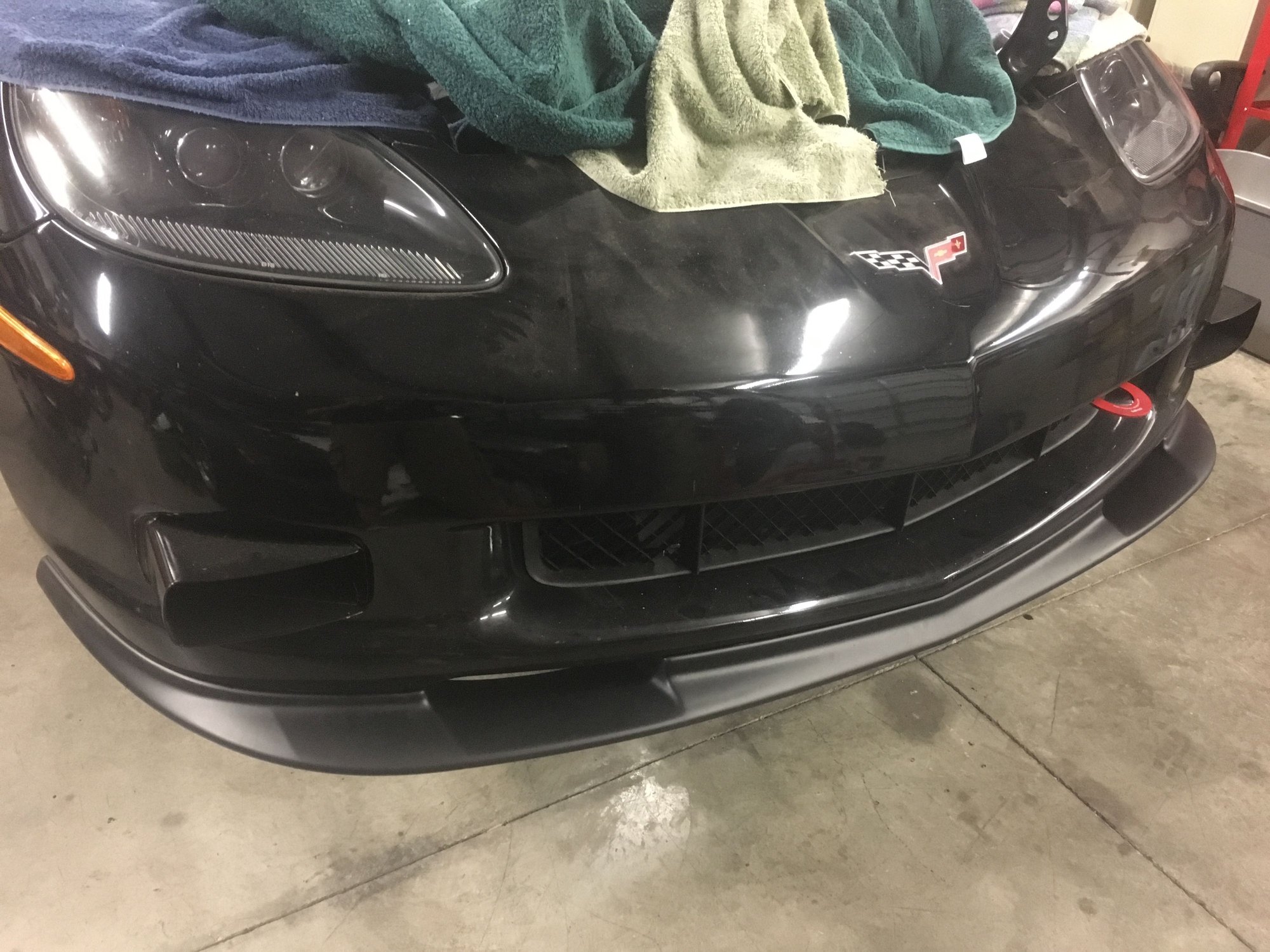

Anything you put in the grill opening (lights, Brake ducts, etc) will either block air going to the radiator (bad) or divert air going to the radiator (also bad).
for a street-driven car, it’s probably not going to have any effect or even on the track if it’s not pushed hard
but if someone needs brake cooling, they might be pushing hard enough that you don’t want to reduce the already-meager cooling ability of these cars.
I made these scoops for my foglight ducts and, with a stoptech trophy big brake kit, I’ve never had brake issues. while there are plenty of things for me to improve, one thing I’m continually able to to is out-brake everyone.
if anyone wants to borrow the wood buck I made to form these around, let me know.
