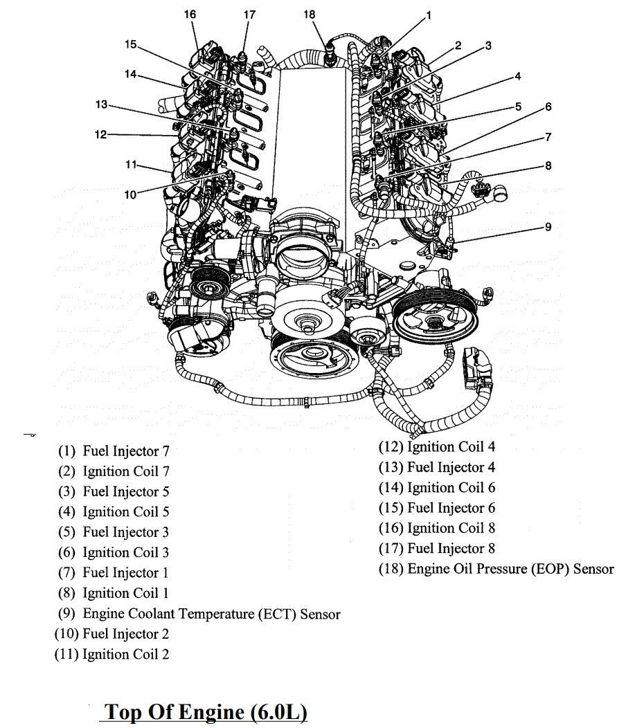

Thanks for the help so far guys, but I’m still lost on this.
before I start taking things apart I want to identify where it is.
all the pics and videos I can find are for the C5 and therefore LS1. I am looking where I think it should be and all I se is an electrical connection with 2 wires not directly connected to a sender just coupler. Does anybody have a picture of the exact location for the C6 & LS2?
thanks

The top video that I attached in post #2 above is of a C6 LS3, which is in the exact same location of the LS2. Here is a diagram from the service manual for an 6.0 LS2 it is item #18

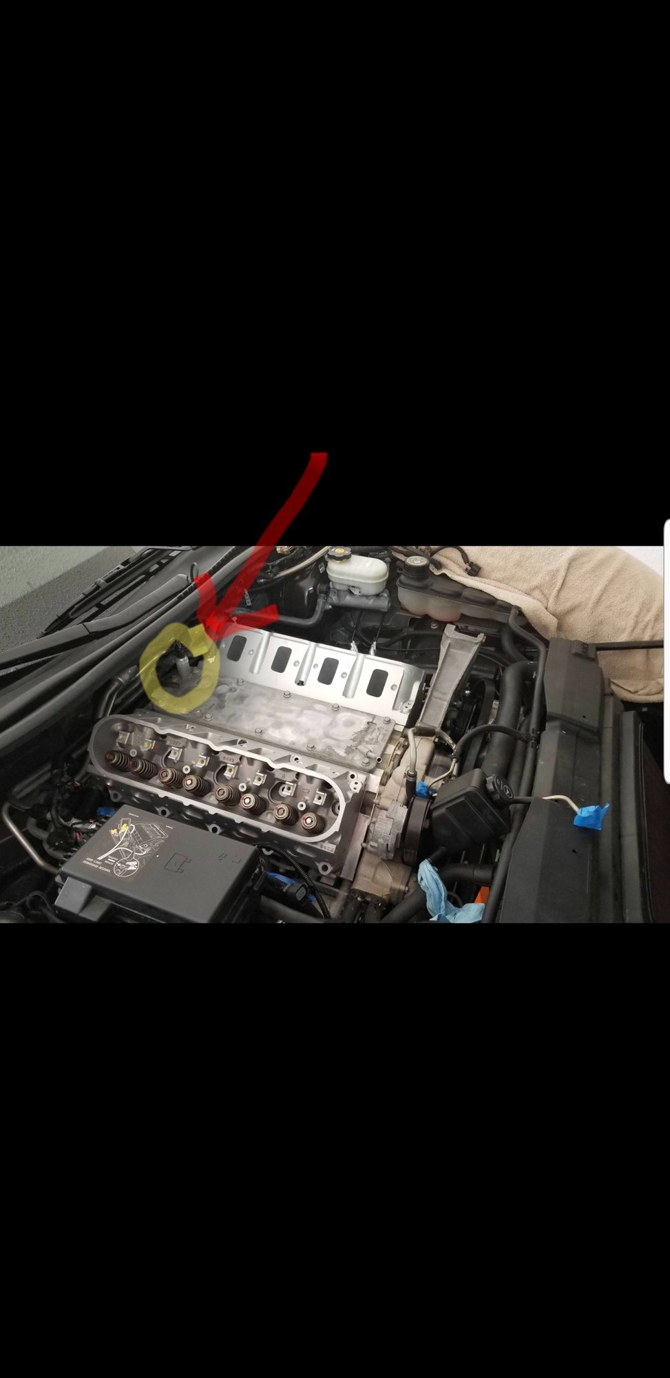

Although I would never cut the cowl to get access to the oil pressure sender, here is a few pics of someone who did. You can see the top of the sender.
That was a butcher job, I have seen cars with perfect cut out using drill bit you use to cut door **** hole, perfectly round, large enough to slip the socket for R&R of the sending unit.
Then they took the plug, and glued it back into the hole, sealing the hole from which the drill bit cut, and after little touch up hard to see anything was done.
exactly what I used 40mm hole already cut when I took the wipers and cover off, all went well except losing the bloody brake reservoir cap somehow!
and having to make a connector for the three pin connector as the one on the car had fallen to pieces! Guess it isn’t the first time it’s been done
