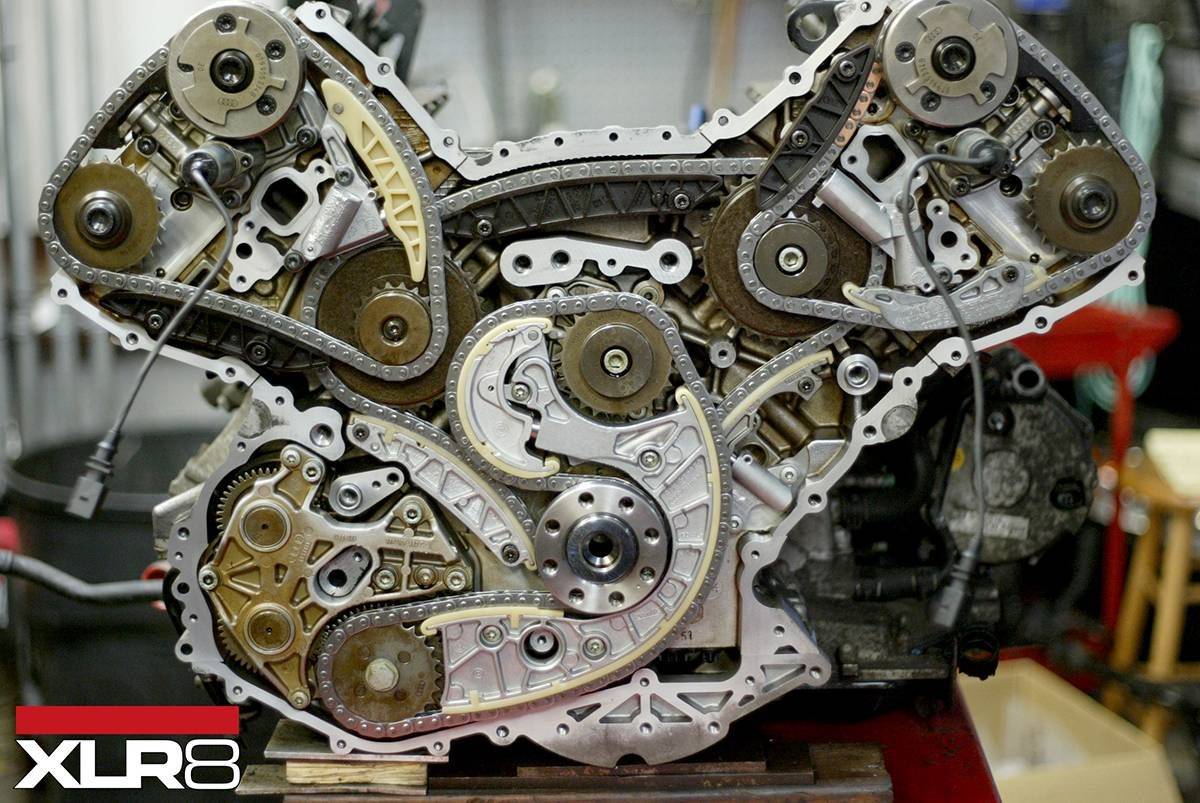

If you want to be intimidated, look up doing a timing chain guide replacement on a 4.2 liter Audi V8. Here is a picture of the back of the engine showing the 4 chains and the clock works:
That actually looks not too bad, maybe try a different example that is actually difficult.
