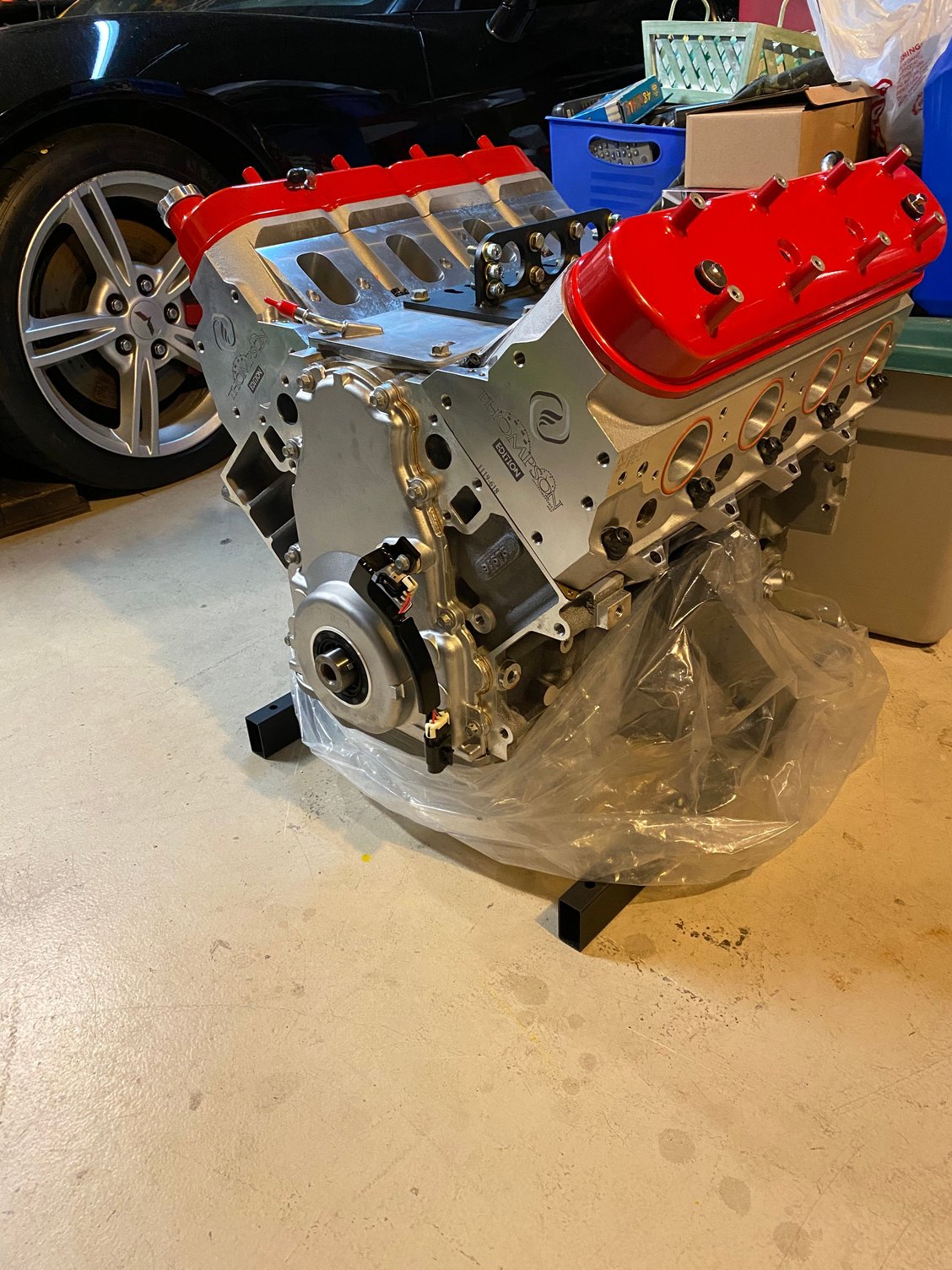

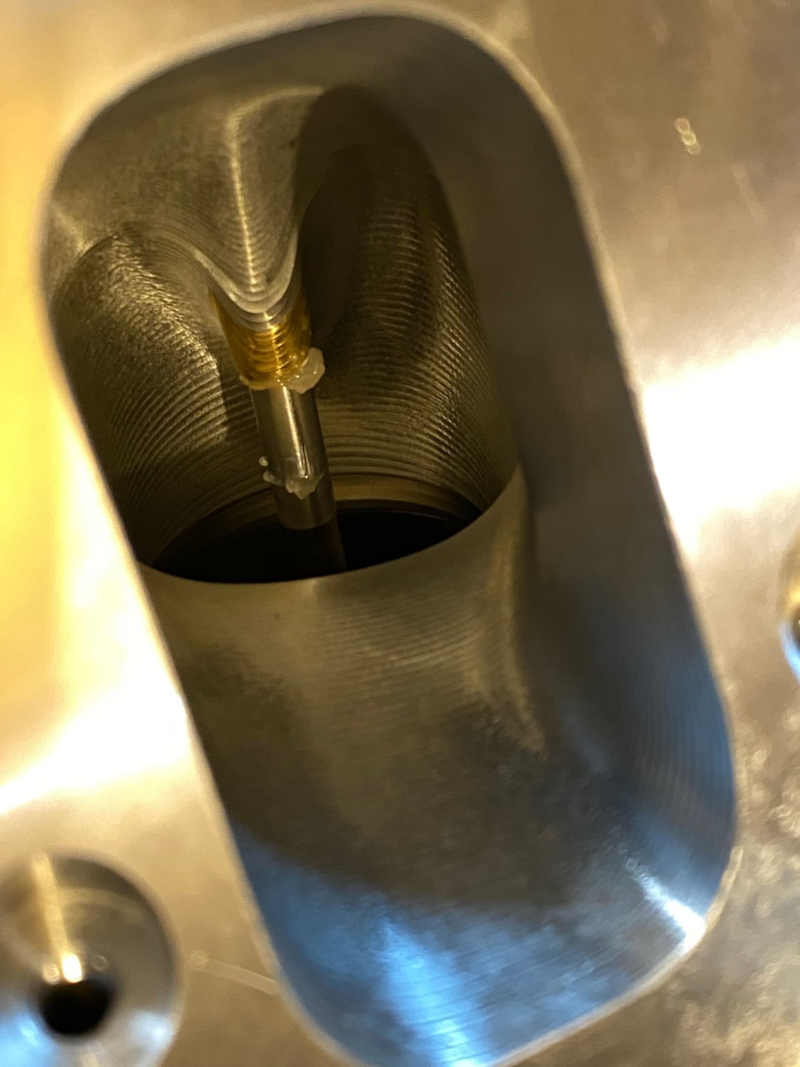

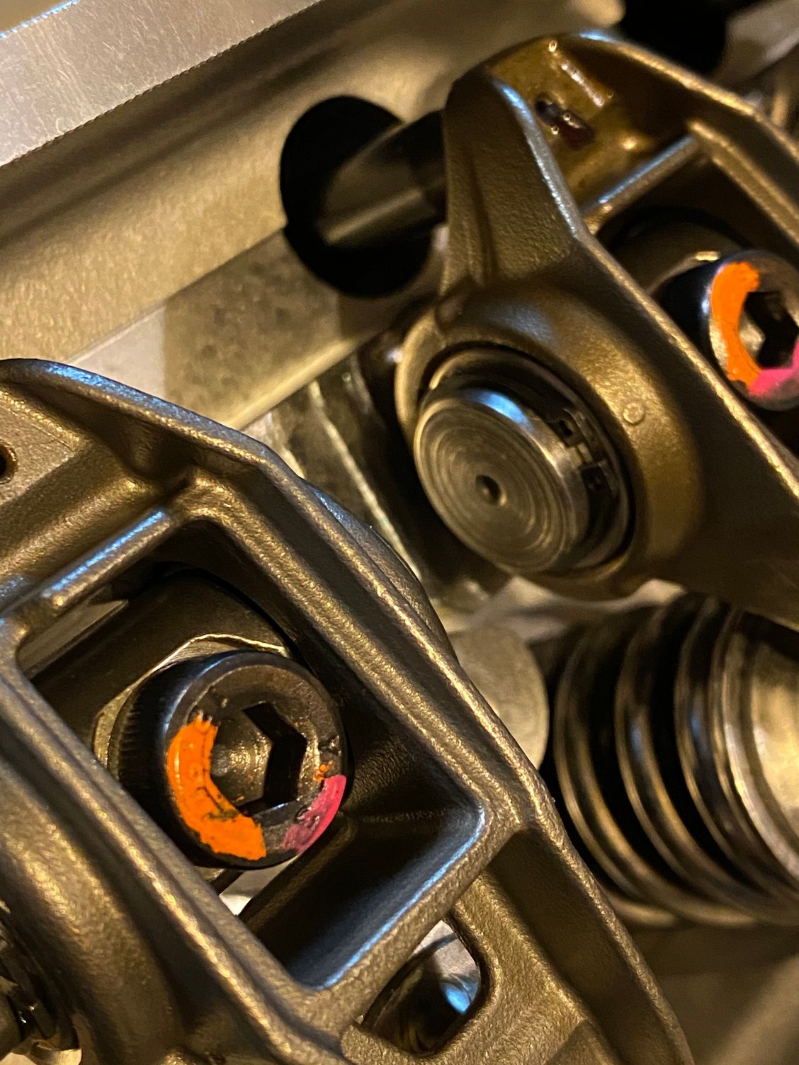

I just picked my new build up from Thompson Motorsports. I’ll do a separate post with the details later but you may want to consider their TMS Frankenstein Heads. These things are real nice!!
