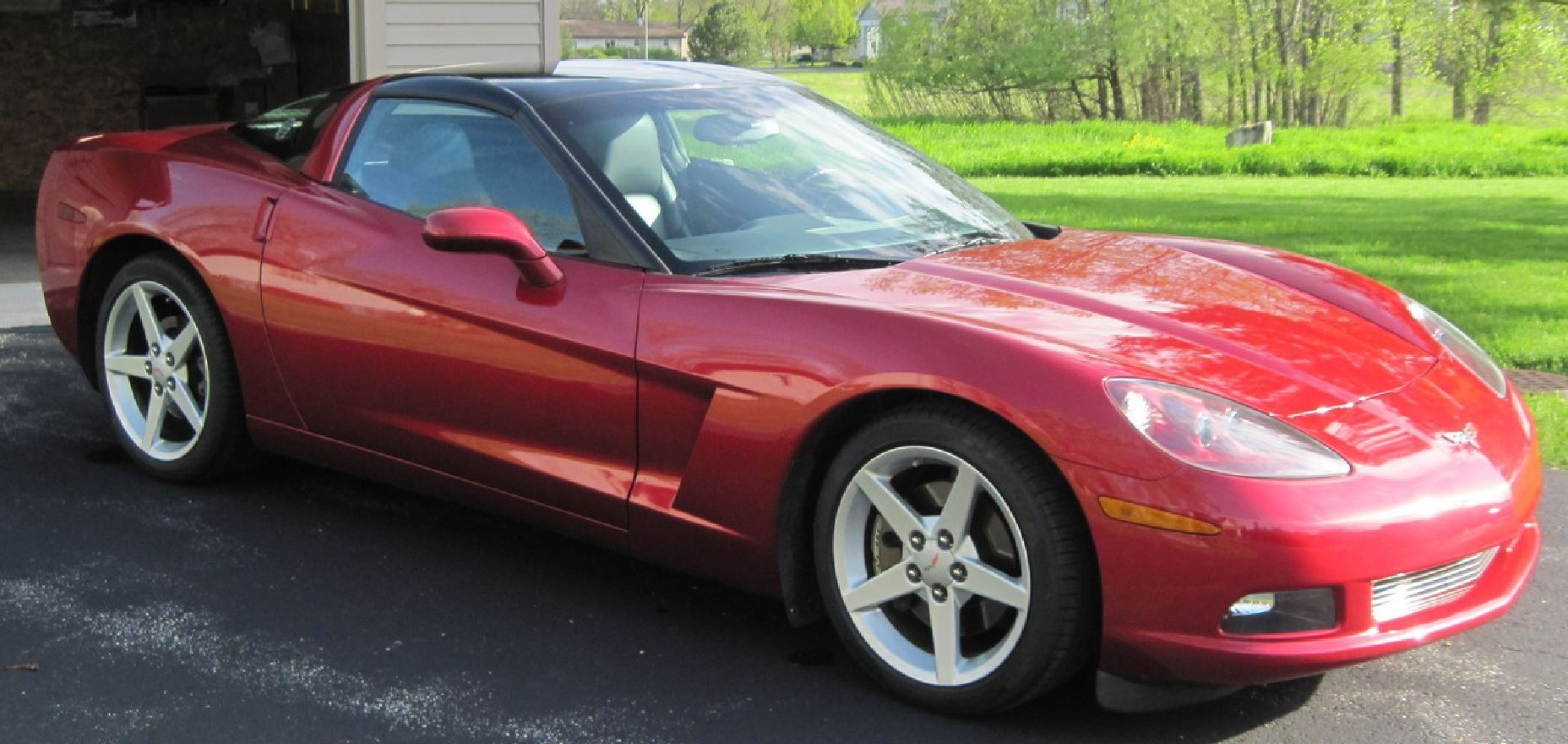

Old Jan 28, 2020 | 01:02 PM
MartyKC's Avatar
MartyKC
Joined: Sep 2019
Posts: 1,534
Likes: 719
From: Janesville WI
Added my car as profile pic, I know it's just a plain jane regular old Red Base coupe corvette, but hey it's my first!
Old Jan 28, 2020 | 01:35 PM
MaxVelocity's Avatar
MaxVelocity
8th Gear
Joined: Jan 2020
Posts: 8
Looks just like mine. Corvettes have had excellent chassis since the C4, so being a base model isn't a bad thing. Mine puts something like 440hp to the wheels and is totally controllable. Outstanding car.
