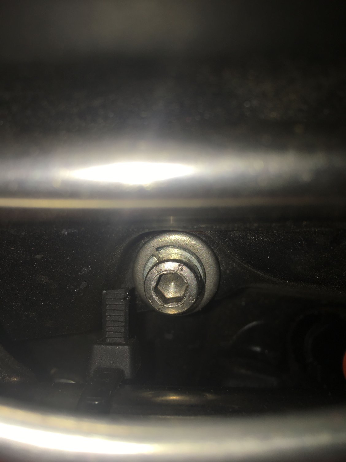

Are bolts coming loose with red lock tite?just putting mine on first time and considering using red instead of blue.thrmal issue.have to go back and retorgue?any suggestions guys?

Thanks guys.since retorqing is required loctite is wrong thing.gonna go with lockwashers.
